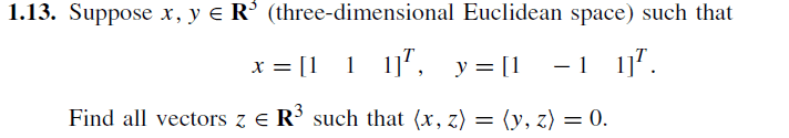

Printed exercise 1.13: x and y in R^3 with x = [1 1 1]^T and y = [1 -1 1]^T; find all vectors z in R^3 such that <x,z> = <y,z> = 0.
Hi Guys, that's what i got
<x,z>=<y,z>
<x,z>-<y,z>=0
<x,z>+<-y,z>=0
<x-y,z>=0
x-y = [0,2,0]
<2*[0,1,0],Z>=0
2<[0,1,0],z> = 0
<[0,1,0],z>=0
So 'im stuck at that. Any ideas?

<[0,1,0],[z1,z2,z3]>=0
Can i assume that the inner product is <x,y>=x1*y1+x2*y2+x3*y3 because it's a Euclidean Space?
How about z=a(xXy), where X is cross product and a is any real number?
This gives you z=(2a,0,-2a).
mfb said:
Well, it is the first part of the solution, yes.
0*z1+1*z2+0*z3=0
z2=0
<x,z>=0
z1+z3=0
z2=-z3
z is all vectors in the form (x,0,-x)
