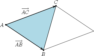

P(3, 0, 3), Q(−2, 1, 5), R(6, 2, 7)
(a) Find a nonzero vector orthogonal to the plane through the points P, Q,
and R.
(b) Find the area of the triangle PQR
[tex]A = \frac{1}{2}|\vec{AB}\times\vec{AC}|[/tex]
Source: http://www.maths.usyd.edu.au/u/MOW/vectors/vectors-11/v-11-7.html

Which is my final answer, and the website marks it as wrong, but I can't see why it's wrong. The magnitude is right which I triple checked, by my own hands and Wolfram Alpha, and the order of the cross product is irrelevant in this situation.
I found a calculator that calculates the area from three 3D points and it spit out the nonexact answer of 14.534. My answer is approximately 7.826, a little more than half. I can't see my error unless I'm completely calculating this area wrong. Thanks for the help.

fresh_42 said:
##\vec {PQ}## looks wrong.
AHHH it was that simple. I was successful in finding a orthogonal vector, but it wasn't the cross product of the two supposed vectors from the points.
Correction:
[tex]\vec{PQ} = \langle -5, 1, 2 \rangle[/tex]
Making the normal vector of interest
[tex]\vec{PR} \times \vec {PQ} = \langle 0,-26,13 \rangle[/tex]
[tex]|\vec{PR} \times \vec {PQ}| = 13\sqrt{5}[/tex]
So the answer is
[tex]\frac{13\sqrt{5}}{2}[/tex]
Let it be the simple subtraction that kills me haha. Thank you
