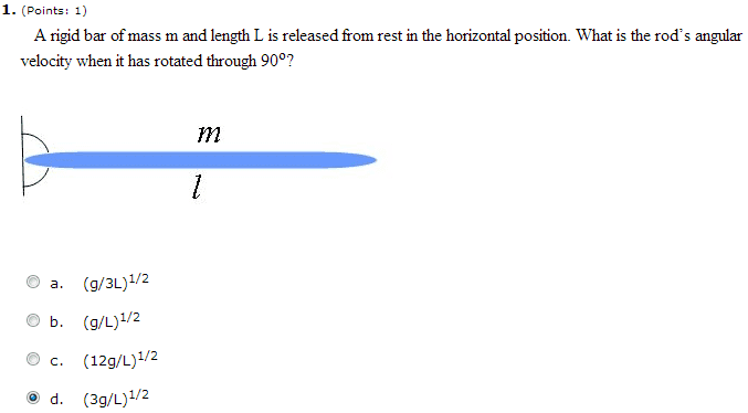

Finding angular velocity using work energy theorem
The discussion focuses on using the work-energy theorem to find angular velocity, highlighting issues with the methods attempted. The first method fails due to the angular acceleration varying with cos(θ), making constant acceleration formulas inapplicable. The second method incorrectly uses potential energy as U = Mθ instead of U = mgh. Participants express confusion about the variable M and its relevance to the problem. Overall, the conversation emphasizes the need to correctly account for gravitational effects when applying these principles.
theBEAST
361

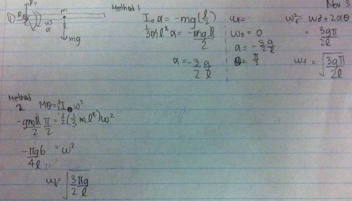

Inertia about pin = ml^2/3
Work done by rotation = M*theta = 0.5(Inertia about pin) *ω2
I tried two different methods and both came out to be the same answer. However they did not correspond to any of the multiple choice answers... What am I doing wrong?
Thanks!
Method 1: The angular acceleration varies with \cos(\theta). So using constant acceleration formulas doesn't work. You simply can't use that method.
Method 2: The potential energy is still U=mgh, not U=M\theta.
Thanks, but why does Mtheta not work?
I'm not even sure what M is.
Moment about the pin.
It's still wrong. It should be \frac{1}{2}M\omega. But that by itself contains no information about the fact it's in gravity.
