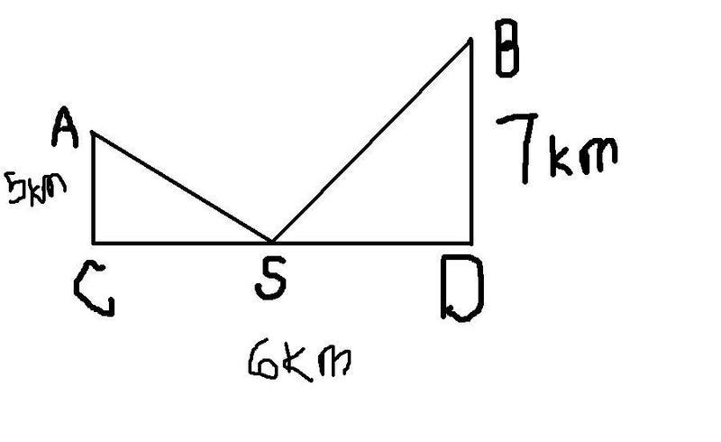

Two towns A and B are 5 km and 7 km, respectively, from a railroad line. The points C and D nearest to A and B on the line are 6 km apart. Where should a station be located to minimize the length of a new road from A to S to B?
I have no clue about the formulas or anything in this one.
This is one where it's a good idea to draw a picture. With a line to represent the railroad, pick two points on it and call the distance separating them 6 km. Draw a perpendicular line from one of the points out to a point A and make that distance 5 km. From the other point on the railroad, draw a second perpendicular line out to a point B and make that distance 7 km. For the purposes of the problem, it doesn't matter if A and B are on the same side of the rail-line.
We are looking for a point S (for the new rail station) between the two points on the rail-line so that the length of a line drawn from A to S plus the length of a line drawn from S to B, which represents the road from A to S to B, is as short as possible.
Thanks for the reply. I've drawn that picture.

You want to use the distance formula to find the straight-line distances from A to S and from B to S, since we are presumably building straight roads to the station from each town. The total length of road needed will be the sum of those distances.
Where does you put the unknown that is going to be the variable that you minimize this distance with respect to?

You'll need to identify the distance of the station from one or the other of the two points on the rail line from which you drew the perpendicular lines out to the towns. The road to each town will have formed a right triangle using each set of the lines you've drawn. The length of each road is the length of the hypotenuse of that right triangle.
You can now make a total distance function which is the total length of road to be built, using the distance I described as the variable.
I have the two right triangles but not sure how to find the distance from C to S or the distance from D to S. The whole thing is 6 km so will it just be 3 km and then do I find the hypotenuse?

This is where you pick your variable. Call either the distance from C to S or from D to S, x. What will the other distance be?
How would you now find the distance from A to S and from B to S? (Triangles ACS and BDS are right triangles.)
