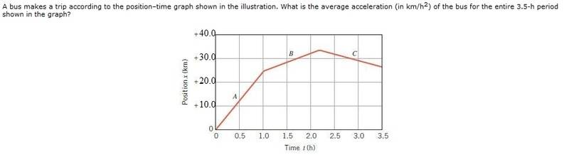

kmb11132
The given data is a graph depicting the distance (km) that a bus travels over 3.5 hours. The trip is broken up into three linear segments. I am supposed to find the average acceleration over the entire trip in km/hr^2. I am told that the answer will be negative.
Edit: The graph I have been given hasn't been made easy to read. The numbers I give below don't coincide with the ones I used when I originally calculated the velocity and acceleration. I'm recalculating those numbers now and attempting to find the solution again.
Segment 1 (from rest): 25 km in 1 hour
velocity: 25 km/hr
avg. acceleration: 25 km/hr^2
Segment 2: 7.25 km in 1.25 hours
velocity: 6 km/hr
avg. acceleration: -15.2 km/hr^2
Segment 3: -5 km in 1.25 hours
velocity: -4 km/hr
avg. acceleration: -5.714 km/hr^2
(Unknown)
(25-15.2-5.714)/3 = 1.362 km/hr^2 :frown:
kmb11132 said:

Are all those values given to you, or have you calculated some of them? I don't think they line up.
Take first hour:
Bus travels 25 km in one hour
average vel = 25 km/hr [i like that]
If acceleration was constant throughout, the final vel will have been 50 km/hr
That means the acceleration will have to have been 50 km/hr2

Yes, I attempted to calculate the velocities and average speed. If average acceleration is:
(v1-v0)/(t1-t0) then I thought that would be (25km-0km)/(1hr-0hr) in kilometers per hour^2 if it started from rest and traveled 25km in 1 hour.
Okay so I see that I'm doing something wrong with the units. My professor willfully leaves units out of equations and tells us not to worry about them for now so I have no idea what's wrong. As you can tell I just started Physics 101 and I'm having a little bit of a hard time. Can you tell me how the hours squared while the velocity is multiplied by two?

So after trying to remeasure and calculate everything accurately here is what I came up with:
Segment #1: +25km in 1hr (given data)
v_i = 0km/hr
v_av = 25km/hr
v_f = 50km/hr
a_av = 50km/hr^2
Segment #2: +7.25km in 1.2hr (given data)
v_i = 50km/hr
v_av = 6.04km/hr
v_f = -37.92km/hr
a_av = -73.26km/hr^2
Segment #3: -6.25km in 1.3hr (given data)
v_i = -37.92km/hr
v_av = -4.81km/hr
v_f = 29.72km/hr
a_av = 52.03km/hr^2
Okay so I can tell I'm still not getting the numbers right. Here is what I thought:
v_i = v_f of the previous segment
v_av = (displacement of segment)/(time traveled in segment)
v_f = 2(v_av) - v_i (<- this is from manipulating v_av = (v_f - v_i)/2)
a_av = (v_f - v_i)/(time traveled in segment)
I can't tell where I'm going wrong, just that I am.

I really can't imagine what the graph supplied looks like, so can't really comment on your calculations.
I do know that a distance-time graph can never have a negative gradient, since there is no direction associated with distance.
If you are actually given a displacement-time graph you could have negative parts.
Does the graph consist of a slope up from the origin, a slope up a little more, then a slope down?
Exactly.
