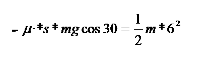

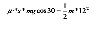

Thanks, Nasu. So I now write the work-energy theorem for the up and the down motion separately:
up motion:
down motion:
But I can't solve for any of the unknown variables s and μ with these two equations.. What am I doing wrong?

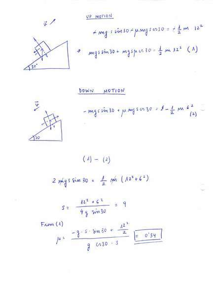

Thank you very much, you two! I got confused because of how I tried to solve it at first. I did it and obtained μ=0.34, which makes a lot of sense. Your help was very useful!
Solved
I'm uploading the solution (although it's a simple problem), in case somebody that got stuck with something similar finds it useful in the future.
