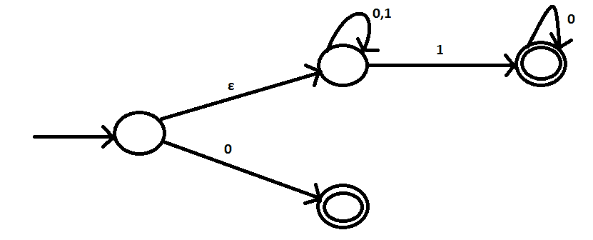

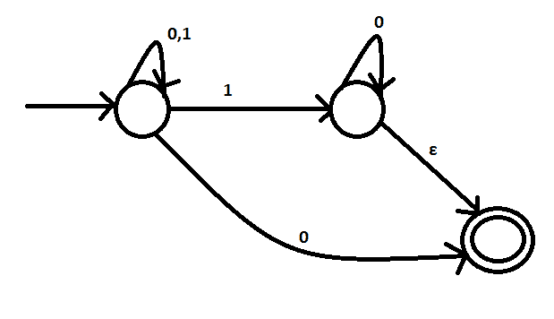

I want to construct a dfa that recognizes the language $((0 \cup 1)^{\ast} 1 0^{\ast}) \cup 0$.
I have thought of the following NFA:
But I am facing difficulties on converting this to a NFA. Could you give me a hint how we could do this?
evinda said:
Hello! (Wave)
Hey evinda! (Smile)
Once we've started recognizing $(0 \cup 1)^{\ast}$, we're too late to match the $0$ at the end.
As it is now we might match for instance $00$, which is not supposed to be accepted. :eek:

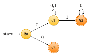

So I think we need to split the first state into 2 states, and put a new start state before them.
One for the $(0 \cup 1)^{\ast}$ part, and another for the $0$-at-the-end part. (Sweating)
I like Serena said:
Hey evinda! (Smile)
So you mean that the following nfa would recognize the language?
Yep. (Nod)

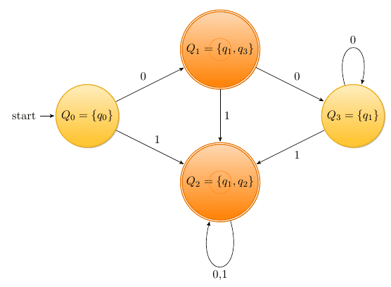

I think we have the following diagrams now, don't we?
The original NFA we found for $((0∪1)^∗10^∗)∪0$ is:
And we got to the DFA:
Right? (Wondering)

Yes, right... (Nod)

Does the DFA we have now correspond to the language $((0∪1)^∗10^∗)∪0$? (Wondering)

No, it doesn't. After having read for example $1^{\ast}$ we don't reach necessarily 1. Also I noticed that it doesn't recognize the word 0.
evinda said:
So do we write some of the states arbitrarily and check if these recognize the language and otherwise we continue the procedure we were talking about before? Or have I understood it wrong? (Sweating)
Not really.
We begin at the start state and we add new states representing the sets of states that can be reached by $0$ respectively $1$. When the only states we can go to are already there, we're done. (Whew)
No, it doesn't. After having read for example $1^{\ast}$ we cannot reach 1. Also I noticed that it doesn't recognize the word 0.
Huh? :confused:
What do you mean that we "cannot reach $1$"?
Which word with $1^{\ast}$ can we not recognize?
Isn't $0$ recognized with $\{q_0\} \overset{0}\to \{q_1,q_3\}$ after which we can stop, since we're in a final state? (Wondering)

Oh yes, you are right! The automaton recognizes the language $((0 \cup 1)^{\ast}10^{\ast}) \cup 0$... (Blush)

Didn't we check at every step what the full set of states was that we could go to from any of the state-sets we had for every input symbol?
In this case, we do not have a transition function for the desired dfa.
I haven't understood when we can't get to new states... (Worried)
Sure we do. We've been building the transition function.
Can you list it?
Can you list it?
Don't we have the following transition function for our initial nfa? Or am I wrong? (Thinking)
$\delta: \begin{matrix}
& 0 & 1 &\epsilon\\
q_0 & \{q_1,q_3\} & \{q_1\} & \{q_1\}\\
q_1 & \{q_1\} & \{q_1, q_2\}& \varnothing\\
q_2 & \{q_2\} & \varnothing& \varnothing\\
q_3 & \varnothing & \varnothing& \varnothing
\end{matrix}$
& 0 & 1 &\epsilon\\
\end{matrix}$
I think we should have $\delta(q_0,0)=\{q_3\}$ and $\delta(q_0,1)=\varnothing$. (Thinking)
Otherwise it's correct.
A ok. And in order to use the known procedure do we have to add new states and get rid of the $\epsilon$-transition?
Or am I wrong? (Sweating)
I don't think so.
We can convert it to states with sets of the original states.
For $\epsilon$-transitions, we just need to draw in additional states that might be reached with an $\epsilon$-transition. (Thinking)
