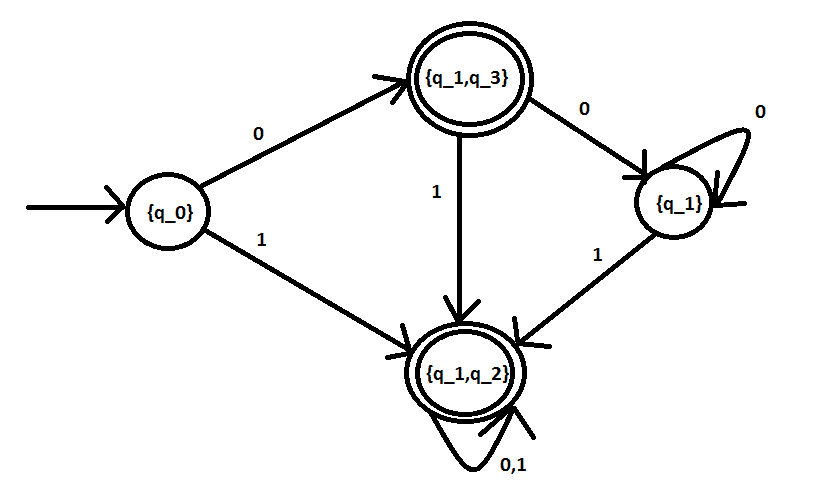

So we have the following transition function, right?$\begin{matrix}
\delta' & 0 & 1\\
\{q_0\} & \{q_1,q_3\} &\{q_1, q_2\} \\
\{q_1,q_3\} & \{ q_1\} & \{ q_1, q_2\} \\
\{q_1,q_2\} & \{q_1,q_2\} & \{ q_1, q_2\} \\
\{q_1\} & \{ q_1\} & \{ q_1, q_2 \}
\end{matrix}$
And these are all the states that are reachable from the starting state. So we get the following dfa
which is the same as we found before, right? (Smile)

  • #34
evinda said:
Oh yes, right... (Blush)
\delta' & 0 & 1\\
\end{matrix}$
Yep! (Nod)
One observation, according to your notes:
http://mathhelpboards.com/attachments/discrete-mathematics-set-theory-logic-15/5765d1469112227-construction-dfa-pr22-jpg
the start state should be $\{q_0, q_1\}$ instead of $\{q_0\}$, although that doesn't really change the DFA. (Nerd)
