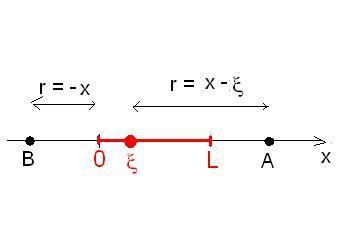

The potential at r distance from a charge element dq is equal to kdq/r. If the rod of length L is placed with its left end in the origin, and the charge element is at distance [itex]\xi[/itex] from the origin, r=x-[itex]\xi[/itex] if x>L and r=[itex]\xi[/itex]-x if x<0. See picture.

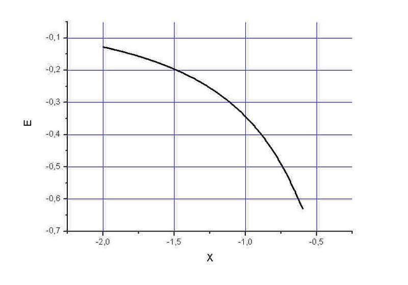

For negative x values then, the potential is
[itex]U(x)=k\lambda \int_0^L{\frac{\xi}{\xi-x}d\xi}=k\lambda (L+x ln(1-\frac{L}{x}))[/itex].
The electric field is shown in the second picture.
ehild
  • Number line with points B, 0, ξ (red dot), L and A marked on the x axis; a red segment runs from 0 to L. Arrows above show r = -x from B to 0 and r = x - ξ from ξ to A.

  • Graph of E against X with a solid black curve falling from about -0.13 at X = -2.0 to about -0.63 at X = -0.6, on blue gridlines with axis ticks from -2.0 to -0.5 and -0.7 to -0.1.
