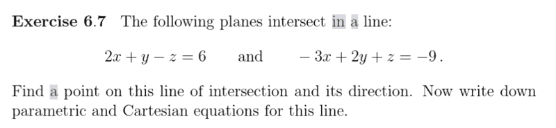

For this problem,

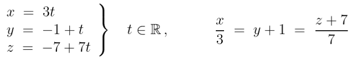

The solution is,
However, I could not get that. By getting the system in REF, I got ##x = 3 + \frac{3}{7}z ## and ##y = \frac{1}{7}z##. Therefore z is a free variable so ##x = 3 + \frac{3}{7}t = 0## and ##y = \frac{1}{7}t##.
Thus equation of line is ##x\hat i + y\hat j + z\hat k = 3\hat i + (\frac{3}{7}\hat i + \frac{1}{7}\hat j)t##
Does anybody please know what I did wrong here?
Many thanks!
ChiralSuperfields said:
Homework Statement: Please see below
Relevant Equations: Please see below
By getting the system in REF, I got x=3+37z=0 and y=17z.
You are right to get
[tex]x=3+\frac{3}{7}z[/tex]
but why do you make it zero ?
Thank you for your reply @anuttarasammyak !
Sorry my mistake. That was not meant to be set to zero.
Many thanks!
For this problem,
The solution is,
I got the same thing but took it one step further, with z = t. So the equation of the line of intersection is ##L = (\frac 3 7 t + 3)\hat i + \frac 1 7 t \hat j + t \hat k##.
In vector form, the above is ##L = \begin{bmatrix} \frac 3 7 \\ \frac 1 7 \\ 1 \end{bmatrix}t + \begin{bmatrix} 3 \\ 0 \\ 0 \end{bmatrix}##
Geometrically, to get points on this line, go out 3 units on the x-axis, and then go off in the direction of <3t/7, t/7, t>.
Your equation doesn't follow from your work that preceded it.
