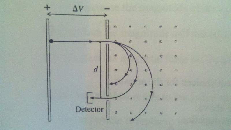

A device is used to measure the charge-to-mass ratio (e/m) of ions by accelerating them using an electric field described by a potential difference , and once they have acquired kinetic energy of known amount, they enter a uniform magnetic field. The particles move in a plane perpendicular to the magnetic field. What is the mass of the ion that enters the detector?
Strength of magnetic field = 0.8 T
d = 6.00 cm
ΔV = 100 V
Ion charge = 1.6 x 10^-19 C

It seems some information is missing. What is d? A sketch of the setup would help, too.

If d in your question is the DIAMETER of the path in the magnetic field you should be able to solve it.

Sorry this is the image https://mail-attachment.googleusercontent.com/attachment/u/0/?ui=2&ik=d3e9366f37&view=att&th=138f2cfebf63fad8&attid=0.1&disp=inline&realattid=1409394640159768576-1&safe=1&zw&saduie=AG9B_P-_1Tbsc3zXwuOtwk13kB5g&sadet=1344103689147&sads=0rBGq4MW_H8NzAdDPKWjvF6cP-g
@truesearch - No I didn't get that equation at all when I tried to do it. Can you explain how you came up with that? I know it's correct because I plugged in the variables and it came out to 4.6 x 10^-25 kg which is the correct answer.
The picture is inaccessible.
Hopefully you can click to make it bigger. Truesearch is right that d is the diameter and that the magnetic field in the path is circular.
