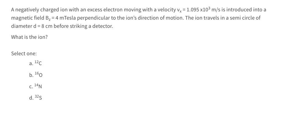

Find the mass of this ion moving in a magnetic field

See below
F = Bqv
F = mv^2/r

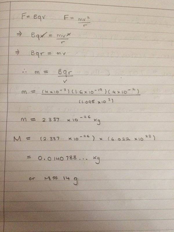

I had started off by equating the magnetic force to the centripetal force, to find the mass of a single ion. Then calculated the mass of what 1 mole of that ion would weigh to identify what the ion is
Hence the answer would be nitrogen (option C) as 1 mole of nitrogen weighs 14g
Would this be the right way of going about it?
Thanks for any help!
Looks fine to me
Cutter Ketch said:
Looks fine to me
Ok thank you, was getting different values beforehand but I believe I must have type the numbers in incorrectly into the calculator
