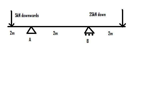

Spakfilla
Find the Fay this is static equilibrium so ƩF=0 and ƩM=0
ƩMa=0
= 2x5 + (-4x25) + (2Fby)
Fby= 45 Newtons
Using ƩFy we get Fay= impossible!
Now if take the moment about point B i get
ƩMb=0
= (4x5)+(-2x25)+2Fay
Fay = 15kN
Using ƩFy we get Fby=15Kn
Can someone tell me where i went wrong please?? I just don't get it
ƩMa=0
Fby= 45 Newtons
not impossible, you get a negative value for Fay; what does that imply about the direction of Fay?
ƩMb=0
Fay = 15kN
what is its direction?
No, watch plus and minus signs and their meaning.
Thanks so much I now see my mistake. Got the directions mixed up! Damn got to be more careful
