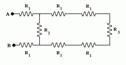

A number of resistors of values R1 = 3.8 Ω, R2 = 80.0 Ω, and R3 = 20.0 Ω are connected as shown in the figure. What is the resistance between points A and B?
Im confused because all I've been calculating is the equivalent resistance, what is the difference between the two?

They are just asking for the equivalent resistance of that network, as seen at the entry points A & B. Just use your series & parallel combination rules to reduce the network to a single (equivalent) resistor between A & B, and you will have your answer.
ok thank-you
The Four R1 and R3 are in series thus those five resistors to the right can be combined by adding the value...(4*3.8+20)=35.2Ω
That resistance is in parallel with the R2 thus the combination of the five and this resistor is equal to 1/(1/35.2+1/80) = 24.4Ω (3sf)
Now the total becomes this plus 2*R1
Total = 24.4+3.8*2 = 32.0Ω (3s.f.)
