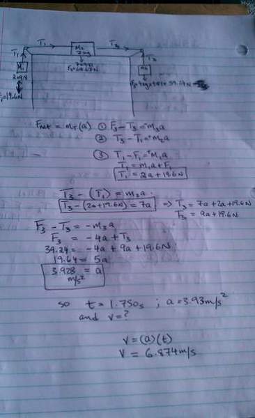

Okay, so I've done this question a bunch of times. Like, a lot of times. I only have 2 tries left to get the correct answer.
1 Incorrect. (Try 1) 8.12 m/s
3 Incorrect. (Try 2) -8.12 m/s
4 Incorrect. (Try 3) 2.31 m/s
5 Incorrect. (Try 4) 6.93 m/s
6 Incorrect. (Try 5) 2.28 m/s
7 Incorrect. (Try 6) 14.8 m/s
8 Incorrect. (Try 7) 4.18 m/s
9 Incorrect. (Try 8) 6.87 m/s
I've attached a picture of another failed attempt.
Please, does anyone know how to do this correctly?
Did you correct the mistake I pointed out? Please repost your new solution. (A scan makes it hard to point out any errors.)
FYI: Your three equations in post #1 are correct, so that's a good start.
I did, but I wasn't really using the T1 system of numbers because if I let equations one and two equal each other, I ended up with two values I didn't know, and I would have to solve for T2 and equate that new equation to equation 3 to find acceleration.
I thought if I did that, I would definitely end up making a mistake, as I was looking for the velocity of M3.
Also, for clarity, do you want me to type out what was on the scan of the paper?
The first thing to do, as you attempted in post #1, is to solve for the acceleration. You have three equations and three unknowns, so it works out OK. You can solve them any way you wish.
Why not just cut and past your work from post #1, making any corrections needed? You were on the right track. (If you want, you can type out what was in the scan.)
