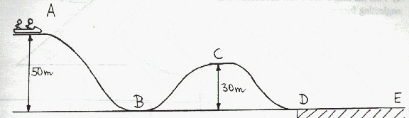

A bobsled run leads down a hill as sketched in the figure above. Between points A and D, friction is negligible. Between points D and E at the end of the run, the coefficient of kinetic friction is µk = 0.4. The mass of the bobsled with drivers is 210 kg and it starts from rest at point A.
Find the distance x beyond point D at which the bobsled will come to a halt.
PE=mgy
(delta)x = ½ v_o2/ mg
I thought the bottom equation should be the right approach but I don't know how to find the velocity given the coefficient of kinetic friction and mass of the sled
Hi disque! :smile:
(I can't see the picture yet)
This is an energy question …
calculate the the work done by friction,
and use the work-energy theorem, which says that loss of energy equals work done. :wink:
