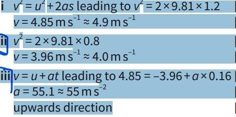

The ball is dropped from rest from an initial height of 1.2 m. Aft er hitting the ground the ball rebounds
to a height of 0.80 m. The ball is in contact with the ground between B and D for a time of 0.16 s.
Using the acceleration of free fall, calculate
the acceleration of the ball while it is in contact with the ground. State the direction of this acceleration.
v²=u²+2as
v= u+at
the v before hitting the ground immediately=4.85m/s
the v after hitting the ground immediately= 3.96m/s
I considered the down positive, then
v= u+at
3.96= 4.85+ (a*0.16)
so a= -5.56m/s*s
The answer is 55m/s*s
The parts that I don't get are why it must be -3.96 and why that velocity becomes initial v.

If down is positive, what is the velocity of the ball after the bounce?
It is negative for sure. So, why couldn't the velocity come out with minus sign in the first place? Thanks for the reply.
I'm not sure what exactly is confusing you. You are told, I imagine, that the speed immediately before hitting the ground is ##4.85 \ m/s## and the speed immediately after leaving the ground is ##3.96 \ m/s##.
If down is positive, then it's up to you to make the initial velocity ##u = +4.85 \ m/s## and the final velocity ##v = -3.96 \ m/s##. You have to apply your physical understanding of the problem to do this. A god of mathematics isn't going to do that for you.

I know that after referring to the key. But, I don't understand the part why it doesn't come out with the negative sign even though I applied the upward movement negative.
What's your calculation for the change in velocity if ##u = 3.96 \ m/s## and ##v = -3.96 \ m/s##?
PeroK said:
What's your calculation for the chage in velocity if ##u = 3.96 \ m/s## and ##v = -3.96 \ m/s##?
The v immediately after hitting the ground is 3.96
The question is why 3.96 didnt come out with negative sign form the beginning.
The next part I don't get is why 3.96 is initial velocity in the answer key. I have no idea about that.

-7.92

Can I add a few pointers...
There are 3 separate parts to the motion:
1) ball falls down;
2) ball hits ground, reverses direction, leaves ground;
3) ball travels upwards and reaches max. height.
The final velocity of each part is the initial velocity for the next part. So we need to take care that we are using the different ‘u’s and ‘v’s correctly.
For example ‘v’ (final velocity) for part 2 is ‘u’ (initial velocity) for part 3.
For part 3:
The ball leaves the ground with velocity u and rises to a height 0.80m (where v=0).
Using ‘down is positive’ note that g is positive but the displacement (s) is negative as it is upwards.
v² = u² + 2as
0² = u² + 2*9.8*(-0.8)
u = ±√(2*9.8*0.8)
The value of u can be positive(down) or negative (up). You must decide which - based on your sign convention and your understanding of what is happening.

Exactly. That is negative. So the acceleration is negative.

You haven't shown your workings that lead to the value of 3.96, but I can guess that you wrote ## v^2 = 0^2 + 2 g 0.8^2 ##. What do you think you should have written that would have led to -3.96, and why?

The answer key is not well written: for the period when the ball is in contact with the ground the initial velocity is +4.85 m/s and the final velocity -3.96 ms so the equation in part (iii) should be ## -3.96 = 4.85 + 0.16g ## (note that part (ii) is also the wrong way round).

The answer key is wrong!

Thank you very much. Now I understand.

Yeah, that's why I didnt get the last part. I did the 1st two part by myself because they are also the questions I needed to answer. Thanks for the guide.
