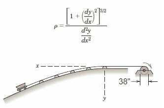

The mine skip is being hauled to the surface over the curved track by the cable wound around the 38-in. drum, which turns at the constant clockwise speed of 96 rev/min. The shape of the track is designed so that y = x2/28, where x and y are in feet. Calculate the magnitude of the total acceleration of the skip as it reaches a level of 3.5 ft below the top. Neglect the dimensions of the skip compared with those of the path. Recall that the radius of curvature is given by
Formula for radius of curvature rho equals the bracket of one plus (dy/dx) squared, raised to the 3/2 power, divided by d2y/dx2, above a sketch of a curved track rising to a drum with a 38-inch dimension marked.
an = v2/ρ
I assumed that the angular speed of the drum is the same as the speed of the mine skip which is constant, so tangential acceleration would be 0.
v = 96 rev/min = 15.92 ft/s.
ρ = 15.33 ft using the given formula.
an = 15.922/15.33 = 16.53 ft/s2.
since at = 0 => a = an = 16.53 ft/s2, but it said my answer is wrong. Is that because at is not 0 and how do I find it?

Can you show your work leading up to ##\rho = 15.33'##? I do not get the same result.
Orodruin said:
I missed the drum and cable and thought it was accelerating due to gravity.
y = x2/28
dy/dx = x/14
at x = 3.5 ft, dy/dx = 3.5/14 = .25
d2y/dx2 = 1/14
ρ = ((1+.252)3/2)/(1/14) = (1.0625)3/2 * 14 = 1.095 * 14 = 15.33 ft
The problem statement seems to indicate that y=3.5', not x=3.5'.
I totally missed that. Thank you so much!
