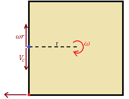

You've changed your answer to part A. It's no longer correct. If you want to use the moment of inertia about the fixed axis of rotation in part A, then the total kinetic energy is ##\frac{1}{2} I_{\rm axis}\, \omega^2##. You would not add an additional ##\frac{1}{2}mV_c^2##.
For part B I don't see how you are getting ##V = \frac{\sqrt{2}\omega l}{2}##. As you say, the edge that is slipping on the table can have only a horizontal velocity. Suppose you consider the cube just as it hits the table. The picture shows the cube at this instant, where the red dot indicates the edge that remained in contact with the table during the fall. The blue dot shows the midpoint of the left face of the cube. Its velocity may be thought of as the velocity of the blue dot relative to the CM plus the velocity of the CM. The velocity relative to the CM is due to rotation about the CM. These velocities are indicated on the picture.
Since the red dot has zero vertical component of velocity, what does that tell you about the vertical component of velocity of the blue dot?

Well if the red dot has zero vertical velocity then the blue dot must also have zero vertical velocity which means that the [itex]v_c = \omega r[/itex] where in this case [itex]r=\frac{l}{2}[/itex] right?

[itex]g(\sqrt{2}-1) =\frac{V^2}{l}+ \frac{l}{6}\omega^2[/itex] Use [itex]V=\frac{\omega l}{2}[/itex]?
[itex]g(\sqrt{2}-1) =\frac{\omega^2 l}{4}+ \frac{l}{6}\omega^2[/itex]
[itex]g(\sqrt{2}-1) =[ \frac{l}{4}+ \frac{l}{6}]\omega^2[/itex]
[itex]\frac{g(\sqrt{2}-1)}{\frac{10l}{24}} = \omega^2[/itex]
[itex]\frac{12g(\sqrt{2}-1)}{5l} = \omega^2=\omega_{b}^2[/itex]
Finally, since [itex]\frac{5}{12}>\frac{3}{2} \Rightarrow \omega_{b}>\omega_{a}[/itex]
where I have used the fact that since the red dot has zero vertical velocity that implies that the blue dot has zero vertical velocity: this implies that [itex]V=\omega\frac{l}{2}[/itex]
Okay so how does that look now?
Yes, that all looks good. (You meant 12/5 > 3/2.)
