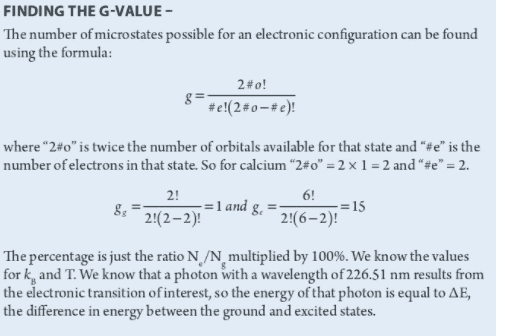

Hello,
I was wondering if someone could show me how to determine the number of orbitals available for a state and the number of electrons in that state. For calcium in the ground state, the electron config is 1s2 2s2 2p6 3s2 3p6 4s2. For the first excited state I assumed 1s2... 4s1 3d1.
From the solution for g_g, why the number of available orbitals is one when 4s is filled? Shouldn't it be zero?
Thanks!
Screenshot of a textbook page titled 'Finding the g-value' giving the microstate count formula g = 2#o! / (#e!(2#o - #e)!) and worked values g_g = 1 and g_e = 15 for calcium.
If there were zero available orbitals, where would the electrons go? It doesn't mean "available for other electrons". It means "available for the valence electrons". (All filled subshells have #e = 2#o, so g = 1; you only need to consider the valence electrons.) There is one 4s orbital into which 2 electrons can go to give the configuration 4s2.

That is what I thought originally but when I applied it to the excited state, it didn't work. But I think my electron configuration for the first excited state is wrong. I think it should be ##1s^2...4s^1 4p^1## based on the selection rules. If that's true then #o is 3 in ##4p^1## and there are 2 valence electrons.

I'm not sure what excited state is being referred to - certainly not the first excited state, as 226.51 nm is much higher energy. The expression for ge would suggest a configuration like 4p2, for which #o is 3 and #e is 2. (4s4p would have g = 12; 2 for the 4s electron x 6 for the 4p.) And the 15 microstates of 4p2 don't all have the same energy - they are split into 1S, 3P and 1D states (and 3P is further split into J = 0, 1 and 2 states). So using the g value in the Boltzmann distribution would be problematic.
Can you provide more context for this problem?

Problem: Use the Boltzmann distribution equation to calculate the percentage of calcium atoms that are in the first excited state in a hydrogen -air flame at 2,250K. The line associated with that transition has a wavelength of 226.51 nm.
Further Question: Is it not true that first excitation occurs when 'one' valence electron transition to a higher electronic state?
