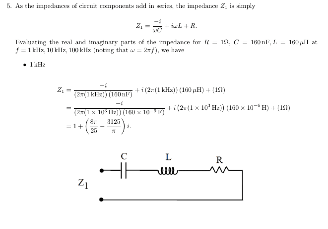

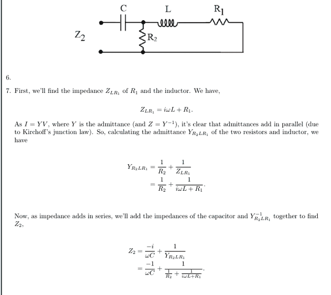

I'm currently taking a junior circuits lab that expects familiarity with impedance (my intro E/M course never covered it), so I just want to make sure I did these two impedance problems correctly (the second one asks merely for a formula, so no calculation was done):
Handwritten-style worked solution: impedance Z1 of a series RLC circuit, Z1 = -i/(ωC) + iωL + R, evaluated at 1 kHz with R = 1 Ω, C = 160 nF, L = 160 µH, giving Z1 = 1 + (8π/25 − 3125/π)i; with a schematic of a capacitor, inductor and resistor in series.
Handwritten-style derivation of the impedance Z2 of a circuit with capacitor C, inductor L, resistors R2 and R1, with the series and parallel combination formulas written out step by step.

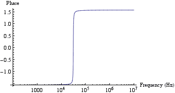

Later in the assignment, I'm also asked the plot the phase of Z1 as a function of frequency. For that (letting Z1 = x + yi), the phase is just arctan(y/x), right?

Looks good to me also.
Caution: in computing arc tan (y/x), be sure to retain the signs of x and y to determine in which quadrant the angle belongs. Arc tan b/(-a) is not the same angle as arc tan (-b)/a.

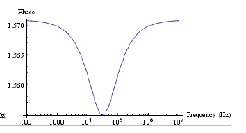

There was actually a little mistake--on the last line I replaced the -i with -1 :P
Anyway, I was actually plotting the phase over 10^6 frequency range, so which quadrant to place it in is a non-issue. It looks pretty neat too (note the x-axis is logarithmic):
Plot of Phase (y-axis, roughly 1.555 to 1.570) against Frequency (Hz) on a logarithmic x-axis from 10 to 10^7; the curve sits near 1.570, dips sharply to a minimum near 1.555 around 10^4.5 Hz, then rises back toward 1.570.
