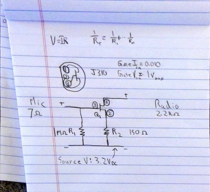

I've been working on a personal project to connect my old H10 series david-clark headset to my UV-5R radio. Up to this point, I've been using the headset purely as a set of headphones to listen in, but I want to be able to transmit with it as well. The problem I'm running into is that the impedance of the microphone is 7 ohms (measured) while the impedance of the radio is 2.2kohms (speced). I've done a little research and know I need to match the impedance of the mic to get it to work with the radio and I did find a basic circuit that I could wire into my setup, but it's not working.
Below is the circuit that I've put together. Source voltage is 3.2V (measured) from the radio.
I'm using a J310 as the amplifier.
R1 is 150 ohms
R2 is 1 M ohm
When I hit transmit, I do get a connection, so I know it's getting a signal. I just think my input signal from the mic is still too small. Do I have the right resistance values?
It's also entirely possible that I'm not remembering my electrical circuit theory that I learned in college correctly. It was a while ago.
In my opinion a FET is a poor choice to drive with a low impedance source. How much have you researched various schemes to do this?

Why have you contradicted the resistor values or identifiers on the diagram?
Do you have a mic that works with the radio?
Did you try connecting the 7 ohm mic directly to the 2k2 mic input, and was it very quiet?
It looks to me like the operating point at ##V_{gs} = 0V, V_{ds} = 10V## is 24 - 60mA. In 150Ω this would make 3.6 - 9.0V, if it could. I think your device is saturated. That might be an issue...

Low Z microphones compared to high Z are typically low signal voltage. It's quite easy to see the signal voltage on a scope with a high Z but signal level on a low Z such as a 500 ohm mic will be considerably lower. I'd have no reason to believe something with a 7 ohm Zout would be any different. May not be visible at all. My suggestion would be to look for various preamp circuits online. First thought would be to use a bipolar transistor in common base configuration.
If you were to use an actual transformer you're transforming the impedance by 314:1. A voltage gain of 17.7 is the equivalent.

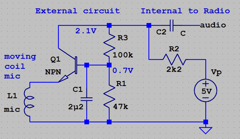

That is correct.
Common base BJT, or common gate FET amplifier circuits, have low input impedance, higher output impedance.
The low impedance mic is connected to the emitter or source of the transistor, the output is taken from the collector or drain.
This is a confused problem, since power must be provided to an amplifier, which must be biased to drive the load. Is there a circuit provided for the Mic input on the radio?
This is the topology of the circuit I would expect when adapting from an electret to a low impedance microphone.

I suspect the radio provides power to an electret microphone, with the required components now probably part of the radio.
My schematic in post #8, shows how to interface a low-impedance moving coil microphone, or a speaker used as a microphone, to a late model radio by using only four components, in an external circuit that may fit in the plug, and that does not require a power supply.

DIYEngine235 said:
Is the capacitor necessary?
Yes, it is essential. The value can be anything from 1uF to 470uF. Below 1uF, the base frequencies will be attenuated. Pinch a tantalum capacitor, or an electrolytic capacitor from a dead circuit board. I expect the voltage gain will be about 35dB which may be a bit low.

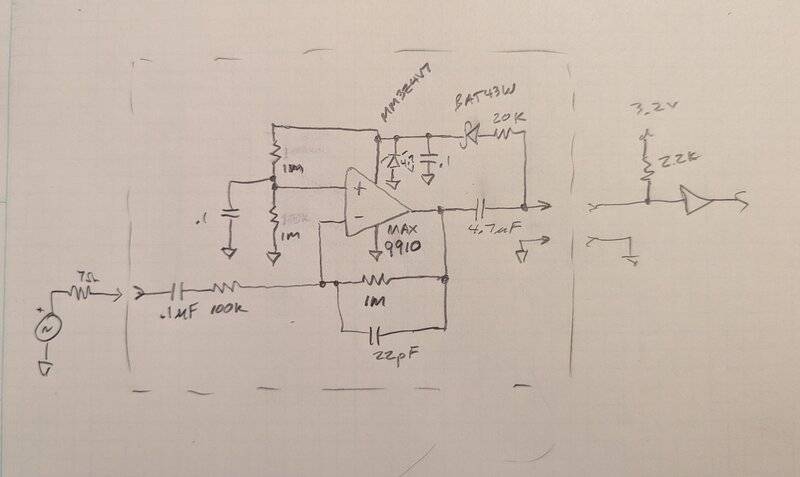

I would still try a uPower op-amp. Powered from the amp input bias. Here's one I sketched up quickly, it definitely needs review, somethings likely to be wrong. But, the point is that you can run real amplifiers off not much power.
https://www.analog.com/media/en/technical-documentation/data-sheets/max9910-max9913.pdf
PS: Maybe an issue with cross-over distortion? IDK. You could bias it into class A operation with a pull up resistor, but that costs power that you might not have.

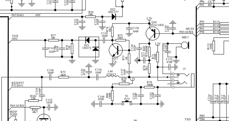

Here is the schematic for the UV-5R radio.
https://www.qrzcq.com/pub/RADIO_MANUALS/BAOFENG/Baofeng--UV-5R-Schematic.pdf
MICin is pin 11 on U2. J1 is the MIC and PTT interface.
It has R70, a 2k2 pull-up to 3.3V when enabled by Q16. You may have to set a bit to enable that supply voltage to the microphone.
Looks like it would work with my post #8 circuit. Change my R2 from 100k to 47k for the 3.3V supply.

Excellent!!! I miss the days when manufacturers published schematics.
PS: BTW, I think they screwed up that audio jack schematic symbol. It shows (to me) that the microphone(s) are disconnected with a floating amp input when the plug is inserted. But we can just pretend they actually built it the right way :wink:. Anyway, it looks like you've got a 3.3V, 100Ω power source available for a "real" amplifier.
https://www.cuidevices.com/blog/understanding-audio-jack-switches-and-schematics
