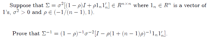

Hi there I'm trying to solve this question:
I figured i should just multiply them together and show that you get the identity matrix, but I'm having trouble cancelling out some of the terms. I'm not sure if I should write them out in matrix form first or just do them as is?

I haven't worked this all the way through, but your idea of multiplying the two expressions seems like the way to go.
Here are a couple of tips that might be helpful. The 1n1n' expressions represent n x n matrices whose entries are all 1's.
The product 1n1n' * 1n1n' works out to be n * 1n1n', which you might need to prove by induction.
It says that 1n is a vector of 1's so shouldn't 11' = n?
They probably mean that 1_n is a column vector. Otherwise the dimensions wouldn't agree. Indeed: (1-\rho)I would be a matrix and 1_n1_n^\prime would be a number, so you can't add them.
I agree with micromass. 1n has to be a column vector.
