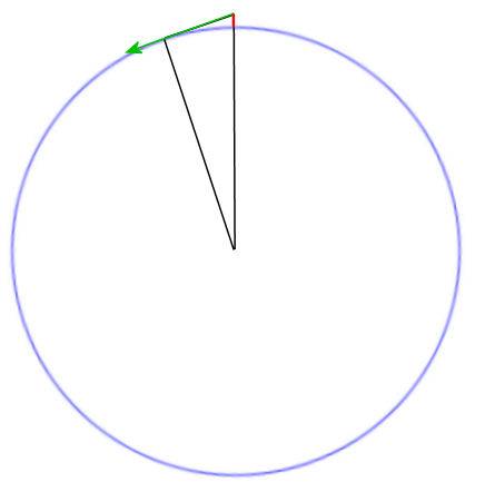

Basically, I've been thinking what height would you have to be at, to see 1° of Earth's curvature.
So this is my math;
Circumference of Earth = 40.075 km ~ 40 000 km
x = 40 000 km
Assuming that Earth is a perfect sphere, and that in 2D it's a perfect circle it's angle would be 360°.
Over of Earth's curvature, the distance (d = x/360°)
d = 40000 km / 360°
d = 111,11* km
(In my school we put an asterisk at the end to define a number without end (e.g 2/3 = 0.66*))
Over that 1° of curvature, I assumed a shape of a triangle where the ground points are defined as dots A and B where the dot A has almost a sharp angle (90°) and the dot B has an angle of .
In that triangle the cathetus between A and B is equal to d = 111,11* km, and the dot C which is elevated above dot A has the other cathetus of undefined height a, while the hypotenuse is c and is directly opposite of the dot A. In this triangle the hypotenuse and the cathetus d are near the same length, and I can not go further than this to calculate the height a needed to look over from dot A to dot B over the Earth's curvature (angle) of . How do I adjust the equation of Pythagoras' theorem to this triangle?
Anyone that can help me?
Thanks!

Something like this
The green line is your sight line which just grazes the horizon from your position at the top of the red line. Just solve for the triangle for the desired angle between the two black lines and find the length of the red line from that.

Janus said:
Something like this
How would I get the length of the green line and how would I encorporate that into the given formula.
So far the only thing I can understand is that the black lines are equal to Earth's radius (r = 6 371 km).
The left black line is equal to r but the right line also has the red line, so it would be higher.
How do I solve for the desired angle, I doubt that Pythagoras' theorem would work for angles.
The tangent function will help here.
If you don't know that yet: The length of the green line is approximately 111 km, you can determine the length of the red line with Pythagoras alone using this approximation.
Yes but I do not know where to include the angle in the a2 + b2 = c2 formula.
You don't. You use trigonometry.
The triangle has three sides:
The hypotenuse (combined black and red line)
Adjacent ( the "black only" line)
And the opposite ( the green line).
Cos(A) = Adjacent/hypotenuse
Thus, using your calculator, find the cos of the angle you are interested in (A).
Divide the length of the adjacent side (equal to the radius of the Earth) by this.
This gives you the length of the hypotenuse. From which you can get the length of the red line.

I understand how I would use Cos there but the red line is included in the hypotenuse, and I need to calculate the red line using the hypotenuse (which includes it)?
Saying that the adjacent is b and the hypotenuse is c, in which c1 is the radius of the Earth (the black line in the hypotenuse) and c2 is the red line in the hypotenuse. (c = c1 + c2).
Therefore to calculate the Cos of A;
Cos(A) = b / c
Cos(A) = b / (c1 + c2)
Cos(A) = 6371 km / (6371 km + c2)
Or did I misunderstand?

As alluded to by jbriggs444, Cos(A) is a known since you already know what A is (in this case 1°) Today, you just use a calculator, and in pre-calculator days you'd look it up on a trig table or use a slide rule.
Thus in the equation, you just rearrange until your one unknown is one side by itself.
[tex]c_2 = \frac{b}{\cos A}-c_1[/tex]
and since c1= b
[tex]c_2 = \frac{b}{\cos A}-b[/tex]
[tex]c_2 = b \left ( \frac{1}{\cos A} -1 \right )[/tex]
Now if A is small, as it is here, and you don't need an exact answer you can get a close answer through the method aluded to by mfb in post #6
For small values of A, the Green line (a) is almost the same as the distance along the surface of the Earth between the hypotenuse (c) and the radial line b.
Thus this distance will be ~b (pi/180) in length if A = 1°
This gives us two sides of the triangle a and b, and we now can find the hypotenuse c, subtract b from it to get c1
For different values of A the arc length becomes ~ bA( pi/180)
And with a bit of algebra we can arrive at the equation:
[tex]c_2 = b \left ( \sqrt { \left ( \frac{A \pi}{180} \right) ^2 +1}-1 \right )[/tex]
But as I said above, this only gives a reasonably close answer if A is small.
