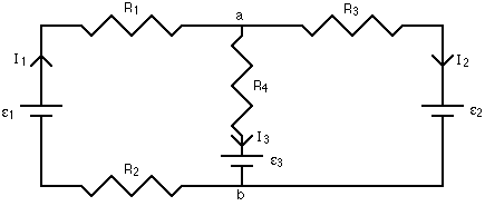

For the following circuit:
How would you deduce the number of currents there are?
I am having trouble predicting how many are there (i am convinced there are 3).
Also, in general, what are some tips for finding how many currents there are?
Choose a current flowing along any path between two nodes.
Yes, there are three in the circuit shown.
