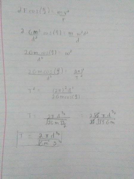

Three identical stars, each with mass m, form the verticies of an equilateral triangle with side length d and rotate in a circular orbit due to their mutual gravitation. What is the period τ of their rotation?
I set up the FBD for each star and am now trying to figure out what to do from there. I know how to get period into the equation from circular motion, but is that all there is to it? The FBD gives different equations for each mass so when I solve I get different periods for each star. What should I be doing here?

Instead of working with x and y components of force, think about centripetal components of forces. Use what you know about circular motion.

I should neglect the force that each is exerting on each other in x or y and only focus on the forces going towards the center of the system (triangle)? I thought about that but I was afraid to try it.
Okay I think this might be right. Using the centripetal components I was able to solve for period using the star at the top which my answer was T = (2πd3/2)/(√(Gm))(31/4). Units check out.
(2Gm2cos(θ/2))/d2 = mv2/d this was my equation from F = ma.
Is the orbital radius equal to d?

I get a different constant factor. Please post all your working.

dsinθ-dsinθ/2 is the distance? Here is the work. Sorry for the blur.

OH MY GOD I DID IT THANK YOU haruspex as usual and Tsny . No dsinθ -dsinθ/2 was definitely not it
