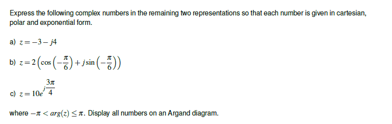

Homework problem text asking to express three complex numbers (a) z = -3 - j4, (b) z = 2(cos(-π/6) + j sin(-π/6)), (c) z = 10e^(j3π/4) in the remaining two forms, with arg(z) between -π and π, and to display them on an Argand diagram.
r=sqrt(a^2+b^2)
θ=arg(z)
tan(θ)=b/a
for a)[/B]
Argand diagram with horizontal axis labelled Re and vertical axis labelled Im, showing a red point in the third quadrant labelled -3 on the real axis and -4 on the imaginary axis, with a line drawn from the origin to the point.
finding the polar form:
r=sqrt(-3^2+(-4)^2)=sqrt(7)
θ=arg(z)
tan(θ)=-4/-3 = 53.13 °
300-53.13=306.87°
-3-j4=sqrt(7)*(cos(306.87+j306.87)
I don't know if my answer is correct because it is given that -π<arg(z)<=π
Is indeed the wrong answer. The second = sign makes no sense. You probably mean to say $$ \tan\theta = {-4\over -3}\ \ \Rightarrow \ \ \theta = 53.13^\circ$$but that is not correct. To satisfy
javii said:
-π<arg(z)<=π
and to not fold everything back to the range ##(-\pi/2 , \pi/2]## the atan2 function was 'invented'.
Your 300-53.13=306.87° (an alternative answer ?) doesn't satisfy "-π<arg(z)<=π, not even if converted to radians.
And to top it all up, ##3^2+4^2 \ne 7## !
So it's back to the drawing board, I'm afraid...:wideeyed:
Not much help (except the reference to atan2, perhaps), but with your drawing at hand I'm pretty confident you can manage on your own and that's much better.

BvU said:
32+42≠732+42≠73^2+4^2 \ne 7 !
my bad its equal 25, meaning r = 5.
I will try to read about atan2, to be honest I didn't knew about it. Thank you

(1) Why are you using degrees when the question expresses angles in radians?
(2) In your computation 300-53.13, where does the 300 come from?
Pretty clearly, it's a typo, where the OP typed 300, but meant 360.
javii said:
300-53.13=306.87°
OK, then: but where does the 360 come from?
