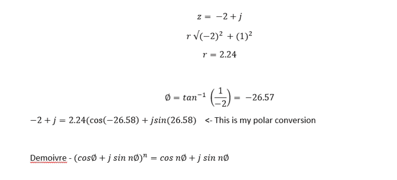

Bear with me guys i could not get the symbols to load see attached, This is where im at if you could verify the polar conversion that would be great.
Following that I need some help applying this into the theorem any relevant assistance/workings would be appreciated
Workings attached with the correct symbols
to plot z8 I presume n needs to be power of 8 but I am getting really high numbers which i do not think are correct

In your work shown in the attachment, you found an angle in Quadrant IV. That is incorrect- it should be in Quadrant II since that's where z is.
If you have a negative value [real or imaginary] the atan does not return the actual argument. In your case the argument is ACOS(-2/2.24) only.
In this case, the actual argument is ##\tan^{-1}(-2) + \pi## or in degrees, about 153.4°.

I ended up getting 625(cos154.48 + jsin154.48) but I am having a hard time understanding how 625 is plotted on an argand diagram?
To plot a complex number of the form ##A(\cos(\theta) + i\sin(\theta))##, rotate counter-clockwise through an angle of ##\theta## (measured from the positive real axis), and then go out that ray A units.
