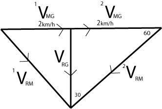

A man walk at a rate of 2 km/h; A rain appears to fall vertically. when he doubled his speed it appears to fall at 30o vertical. Find the real speed of the rain.
Help me to do this question. I cannot understand what my teacher said about relative motion. Please explain me how find the answer for this question.

let VMG be the velocity of the Man relative to the Ground,
VRG be the velocity of the Rain relative to the Ground,
and VRM be the velocity of the Rain relative to the Man
then draw a vector triangle MRG for each of the two situations: the length of the RG side will be the same in both triangles, and the length of the MG side will be 2 in one triangle and 4 in the other triangle :smile:

In both instance VRM is constant.
then sin60 = 2/x
x = 4/√3 = 2.3 km/h
is this right

No, VRG is constant (it's the same Rain, so its velocity relative to the Ground is the same).
Try again … draw the two triangles, with a shared side …

I got triangle like this
then tan60 = VRG /4
4√3 = VRG

That's the right idea, but you've misinterpreted the question.
Your diagram show the rain falling vertically, but it doesn't.
Also, your arrows are going the wrong way round each vector triangle …
they have to match up so that VRG = VRM + VMG
(or VRM = VRG + VGM = VRG - VMG).
Try again. :smile:
