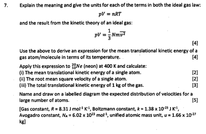

The screen shot I have attached is the original question, I think I'm ok up until the Ne part.
My answer just seems like a ridiculous number, I haven't had much experience with this so don't really know what an 'normal' KE for 1kg of gas would be.
