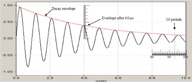

Determine ##q(t=0)##, ##i(t=0)##, the phase difference ##\phi##, angular frequency ##w## and the time constant ##\tau## from the graph of the capacitor waveform below:(pulse voltage source)
For this circuit we have ##q(t)=Ae^{-\frac{t}{2\tau}}\cos(\omega t+\phi)## therefore
##v(t)=\frac{A}{C}e^{-\frac{t}{2\tau}}\cos(\omega t+\phi)##
##i=\frac{dq}{dt}##
For ##q(t=0)## I get ##q(t=0)=A\cos(\phi)##, for ##i(t)=\frac{dq}{dt}=-A(\frac{t}{2\tau}e^{-\frac{t}{2\tau}}\cos(\omega t+\phi)+\omega\sin(\omega t +\phi)e^{-\frac{t}{2\tau}})## therefore
##i(t=0)=-A\omega\sin(\phi)##
For the phase difference since at ##t=0## the function is starting at 0 and we have a cosine the phase is ##\phi=-\frac{\pi}{2}##
To find ##\omega## I used the fact that a fourth of the period corresponds to ##\pi/2## so taking a time difference that satisfies this ##t_1=0## and ##t_2=0.533\mu_s## we have ##\omega t_2-\omega t_1=\omega(t_2-t_1)=\pi/2\Longrightarrow \omega=\frac{\pi}{2t_2}## (Since ##t_1=0##),
This gave ##\omega=2.9rad/\mu_s##
Now I'm stuck trying to calculate ##\tau##, I wanted to sub into my voltage formula ##t=2\tau## then I would have ##v(t)=\frac{A}{C}e^{-1}\cos(2\omega \tau-\pi/2)## since I wanted to look graphically for the time where the amplitude became ##\approx \frac{1}{e}## of the original but I'm not sure what to do with the ##\cos## term.

Hint: What happens to the size of each successive maxima?

They decrease (Is the amount it decreases by related to ##\tau##?). Or am I just supposed to take two values of ##t## and ##v## and then plug these into the formula and divide one by the other to solve for ##\tau##?
You can use your knowledge of v(t) for many different times to solve for the key variables, yes.
It does help to exploit particular times though .. ferinstance, part of your issue was what to do with the cosine part right? well:
At each peak, what does ##\cos(\omega t + \phi) = ##
... if ##t_1## and ##t_2## are two peaks - what is ##v(t_1)## and ##v(t_2)## ?
(write it out without plugging values in...)

Okay I wrote out the two terms and obtained this formula ##\tau=\frac{(t_1-t_2)}{2\ln\frac{v_2}{v_1}}## which using voltages and time values for two maximums gave me ##\tau\approxeq 2.3\mu_s##.

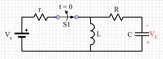

It looks like a transient response curve, so there's probably a signal generator set up to give it a kick at regular intervals, then the response is followed for some time and allowed to die out before the next kick. You're only concerned with the transient solution.
You can model it as a voltage source with a current limiting resistor and switch that gets some steady-state current flowing through the inductor. Something like:
The capacitor charge and voltage will be zero initially, since at steady state the potential across the inductor will be zero. Then at "t = 0" the switch opens and the current path is isolated to the RLC circuit. The capacitor charge and voltage will then follow a decaying sinwave (or a suitably shifted cosine as you've done).

Sorry I'm having some trouble understanding this. So we're looking at the steady state of the circuit before the switch is opened, in the steady state the capacitor will become an open circuit and a total current ##i=\frac{V_s}{r}## will be passing through the inductor. Now when the switch is opened is the capacitor fully charged so it essentially acts as the voltage source and begins to discharge?

No, the capacitor starts out with zero charge. As I stated, the potential difference across the inductor at steady state is zero. So the resistor and capacitor have zero potential across them. In the instant before the switch opens the inductor is carrying a current and the capacitor is uncharged.

I'm confused as to how the capacitor charge will follow a decaying sine waveform if it's starting uncharged. I feel like I'm failing to see something obvious here.
Take a close look at the curve in the image that you presented. The capacitor voltage starts at zero and doesn't hit a maximum until a quarter cycle later.
It's the inductor that supplies the initial energy to the circuit when the switch opens. The capacitor first begins to charge when the inductor current is forced to flow in the RLC loop.

Thanks this makes sense now, so then I should just use kirchhoffs law on the loop to obtain ##L\frac{di}{dt}-\frac{q}{c}-iR=0## which after changing to one variable ##q## and multiplying by -1 becomes (I'm kinda concerned about this step actually since I just read http://web.mit.edu/sahughes/www/8.022/lec09.pdf and sometimes they use ##i=+\frac{dq}{dt}## and other times ##i=-\frac{dq}{dt}##) $$\frac{q}{c}+\dot{q}R-\ddot{q}L=0$$ which is solvable by substituting ##q=e^{rt}##, The only troubling thing is that there will be multiple cases for this solution.
What values were you given for the circuit components? From what I can see in the thread you're told that the capacitor is 1 nF, is that correct?
It may not be necessary to solve the differential equation if you already have the form of the solution. The parameters for the equation can be obtained by suitable measurements on the decay curve.
The angular frequency can be found by counting off the some number of full cycles and reading off the time. I've indicated the location where ten full periods just completes. Read the time (I've provided a "ruler" with a fine scale) and calculate ω. For the damping constant (attenuation factor ##\alpha##), pick a convenient location in the middle of the curve where the envelope just "kisses" a peak and use the time and envelope value there to find ##\alpha##. The envelope follows an exponential decay,
$$E(t) = E_o e^{-\alpha t}$$
By inspection it looks like ##E_o## is 1 V, but you could always measure a pair of values at a different peaks and slog through the math to fit the curve.
You should be able to tell the initial capacitor charge by inspection since you can read the initial capacitor voltage from the curve.

Yea just C=1nF was given. Thanks for the added details to the graph, it was very useful for obtaining these values. For the angular frequency using ##\omega=\frac{10*2\pi}{9.32\mu_s}\approxeq 6.75##rad/##\mu_s##, then for the damping constant ##\alpha## taking the max at ##t=4\mu_s##, ##E(8.59\mu_s)=0.4## and ##E_0=1## we have ##\alpha=-\frac{\ln(E_t/E_0)}{t}=229,072/s##. Looking at the graph initial charge on the capacitor appears to be approximately 0. Is it a bit odd that my new value for ##\omega## doesn't match up with my old value?
Potatochip911 said:
Is it a bit odd that my new value for ω doesn't match up with my old value
Well, you did use a very short time period on the graph for that first try. I think the measurement uncertainties were probably comparable in size to the measured value of the time. It's always better to use a large span with multiple periods to reduce the relative error.

@gneill Is it valid to solve for ##\tau## using the diffraction envelope by looking for when ##E(t)=1/e##? I'm assuming this is why it was useful to solve for ##\alpha##.
That's "decay" envelope, and yes it's valid. If you've got an accurate decay envelope then you can do that. Otherwise, the only points you can guarantee are accurate fits to the decay curve are the waveform peaks. Note also that ##\tau = 1/\alpha##.
