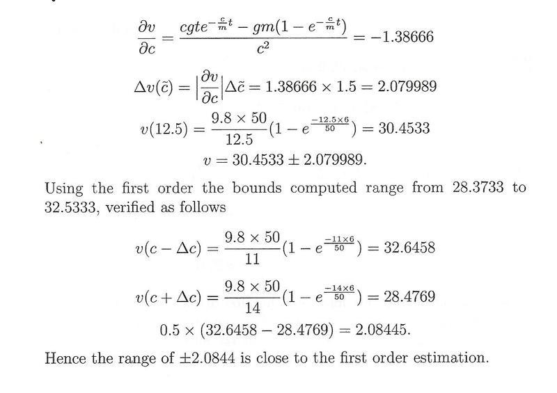

The equation for the velocity of a falling parachutist can be computed by,
[tex]v(t) = \frac{gm}{c}(1-e^{-(\frac{c}{m})t})[/tex]
Use a first-order error analysis to estimate the error of v at t = 6, if g = 9.8 and m = 9.8, c = 12.5 plus or minus 1.5.
I've never done "first order error analysis" using taylor series so I've looked at the solution to try and do the problem backwards but I can't make sense of what's going on. (See figure attached)
Handwritten worked solution for first-order error analysis: partial derivative of v with respect to c, delta v from delta c, v(12.5) = 30.4533 +/- 2.079989, and a check using c minus and plus delta c giving range 28.3733 to 32.5333.
Can someone clarify to me what they're doing here? I need the ideas behind what's being done.
Thanks again!
  • Handwritten worked solution for first-order error analysis: partial derivative of v with respect to c, delta v from delta c = 1.5, v(12.5) = 30.4533 +/- 2.079989, and bound checks giving range 28.3733 to 32.5333.
He is using approximation by differentials. In one variable, say you have a function f(x) and you know it and its derivative at x0. You can approximate its value at some nearby point x1 by
f(x1) ≈ f(x0) + f'(x0)(x1-x0)
You may see it written as
f(x1) - f(x0) ≈ f'(x0)(x1-x0)
or
Δy ≈ f'(x)Δx
For example, the second line in your image is exactly this last equation with y and x replaced by v and c.
