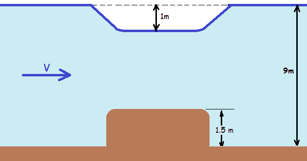

In a horizontal rectangular open channel 20 m wide the water depth is 9 m. When a
smooth hump 1.5 m high is introduced in the channel floor, a drop of 1 m is produced in
the water surface. What is the flow rate, neglecting energy losses? It is proposed to place
a pier at the centre of this channel on the hump. Determine the maximum width of this
pier if it is not to cause any backwater effects.

I'm not sure I'm interpreting the problem correctly. I have attached a figure. I assume the hump goes across the entire width of the channel.
Ragnar1995 said:
First of i tried to find velocities at each point using :
h+(v^2/2g)=constant
9+v1^2/2g = 6.5+v2^2/2g
and i got to v1-v2=7m/s, wasnt sure what to do from there,
[/B]
When using the formula h + v2/(2g) = const. you have apparently chosen two points in the fluid flow to apply the equation. Can you describe the location of these two points? Where are you choosing h = 0? Have you measured the height h for the two points from the same reference level (h = 0)?
Also note that ##\sqrt{v_2^2 - v_1^2} \neq v_2 - v_1 ##.
Think again about that 6.5m. Remember that this term represents the lost PE. How does the height of the bump come into that?
