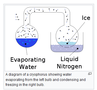

It’s called a cryoforus system. Two containers connected by a tube. One container has warm water in it at 40 degrees Celsius and the other container is kept near freezing. When you pull a -30 in hg vacuum the water will boil and the water vapour will try to fill the vacuum. As this happens the water vapour will travel the tube and enter the cold container where it will condense back to water provided the vacuum is not sufficient to boil the water in the cold container. The cycle should continue until the water is evaporated or temperatures equalise provided there is no leaks and the vacuum holds . It’s an old idea.
I have found it difficult to find how fast the evaporation rate is in a vacuum,
How to calculate how fast the water vapour travels from one container to the other in a vacuum , and what is the boundary layer of water vapour At 40 degrees The cryoforus idea could be a more efficient method of water desalination .

No air. Water vapour and then condense back to liquid. The idea of using 40 degree water is the energy needed is much less then heating water to 100 degrees and result is the same. Liquid to vapour and then condense to liquid. At 40 degrees in a vacuum less energy is required then getting the same change in waters phases at 100 degrees.

Here's the wiki on it:
https://en.wikipedia.org/wiki/Cryophorus#:~:text=A cryophorus is a glass,tube of the same material.
It contains other components you haven't yet specified, such as a heat source and sink. What should we do about that? Your description of how you want it to work is still woefully inadequate:

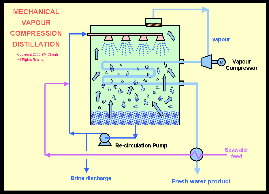

Your idea is already a thing, but it doesn't seem like you've really researched it, and you really should. Just google "Vacuum distillation". Here's an example:
https://sites.google.com/site/kjdesalination/vacuum-distillation
The steps in the process are:
1. Feed water.
2. Spray water into low pressure chamber. Some water flashes to steam, the rest falls into a pool at the bottom of the chamber (falling through a heat exhchanger where more boils).
3. Steam is collected, pressurized to atmospheric pressure(and heated), then run through the heat exchanger in the chamber to condense it into water.
4. Hot output water preheats feedwater.
5. (Not shown) Your water starts warm, so your fresh water product is pretty hot, and should go through an additional heat exchanger to cool it.

Here’s the link to what a cryophorus system is. It’s been around since 1813. https://en.wikipedia.org/wiki/Cryophorus.
The concept works. Since asking for the equations to find out if this could be built to be a better way of desalination I have been informed of everything but the equations. Some have hinted that the cryophorus doesn’t even work. Current desalination of seawater in Australia costs between $5-$10 a kilolitre and is very energy intensive. As a thought experiment, could the cryophorus be used to deliver fresh water and be less energy intensive?
