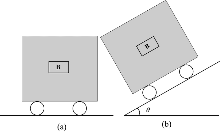

A body is capable of remaining stationary inside a liquid in a closed box (that means its density is same as that of liquid) . If the whole system is placed on inclined plane and allowed to slide down then:
1. body moves up relative to liquid
2. moves down relative to liquid
3. stationary wrt to liquid
4. move up for some angle and move down for some other angle..
ATTEMPT
at first i thought density is same so body doesnot move relative to liquid but the answer is 4... can anyone explain...??

The drawing/sketch of the problem shows liquid filling the box, so it can't be moved relative to the liquid.

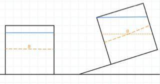

I misused the word 'depth'. well in comparison to the liquid surface the position of the body doesn't change but it does change in comparison to the top of the box.
In this illustration the blue line shows the liquid level, the Orange dotted line shows the position of the body and the dashed – line shows the position in comparison to the top of the box.
Why do you assume (a) that the fluid does not fill the box and (b) that the top of the liquid will be level as the box accelerates down the slope?
That is only for stationary box, actually I don't understand the question quite well!

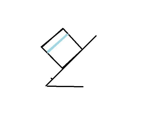

Perhaps the easiest way to see how it will behave is to consider a small blob of the liquid at its surface. It is surrounded by other liquid below and 360 degrees around. So which way does the net force on it from the rest of the liquid point?
i guess that it will be parallel to inclined surface .as the net force should be perpendicular to liquid free surface and the so liquid sholud be parallel to surface.
am i right?
jonny23 said:
i guess that it will be parallel to inclined surface .as the net force should be perpendicular to liquid free surface and the so liquid sholud be parallel to surface.View attachment 77176 am i right?
In the absence of friction on the slope, yes - well done.
(Can you work out what would happen with some kinetic friction?)

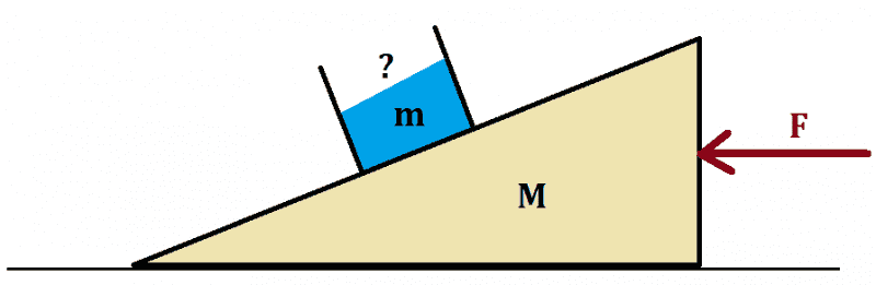

An interesting modification of the problem is to allow the incline to slide on a frictionless, horizontal surface. Suppose a horizontal force of arbitrary magnitude is applied to the incline. If there is no friction between the box and the incline, what is the orientation of the surface of the water? (A special case of this would be to let F = 0 so that the incline recoils to the right as the box slides down the slope.) I get a simple answer (for arbitrary F, M, and m).

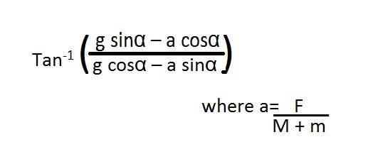

i got this
jonny23 said:
That's what I get if the box does not slip along the incline (due to sufficient static friction, say). But if there is no friction between the box and the incline, then generally the box will either slide down or up the incline depending on the strength of the force F.
