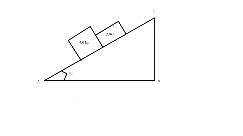

Two blocks,in contact,slide down an inclined plane ##AC## of inclination ##30^°##,The coefficient of kinetic friction between the ##2.0 kg## block and the incline is ##μ_1=0.20## and that between the ##4.0kg## block and the incline is ##μ_2=0.30##.
Find the magnitude of the acceleration.

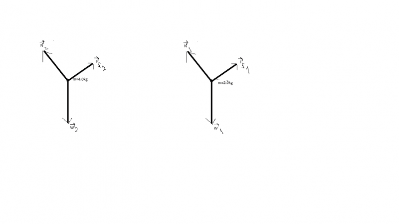

Ok I need to draw free body diagram,after that I can solve the question I guess.I stucked in the free body diagram,I don't know its true or not.there's pic in the attached files.
Is there will be any action-reaction force pairs ?

If you draw individual free body diagrams, don't forget the forces the blocks exert on each other. (Those would be 3rd law pairs.)
But why not treat the two blocks as a single "system"?
They have differenet friction constant and ##N## are different This 2 body diagrams seem simpler ( maybe not but for me yes )

Using separate diagrams is perfectly fine! But then you must include the unknown contact force that the blocks exert on each other.

Since they move together, it's easy to treat them as a single system. But you don't have to.
(Think about it: If a single block were sliding down the incline you could -- mentally -- imagine the block divided into two pieces and treat each piece separately. You'll get the same answer as usual, though.)
Parallel to inclined plane is x and and the perpendicular to that axis is y.Down is +x and up is +y
##m_2a=m_2gsin(30^°)-μ_2m_2gcos(30^°)+F_{12}##
##m_1a=m_1gsin(30^°)-μ_1m_2gcos(30^°)-F_{21}##
Since
##F_{12}=-F_{21}##
lets subtract them.
##a(m_2-m_1)=gsin(30^°)(m_2-m_1)+gcos(30^°)(m_1μ_!-μ_2m_2)##

Careful with signs.
Let's let ##F_{12}## stand for the magnitude of the contact force. In the first equation, it will appear as ##+ F_{12}##; in the second, as ##- F_{12}##.

But ##F_{12}## in the +x direction and ##F_{21}## in the -x direction. that's why there's "-" sign
You are counting the sign twice, which is why your final equation is incorrect.
What you meant to do was use ##+ F_{12}## in the first equation and ##+ F_{21}## in the second equation. Then, using ##F_{12} = - F_{21}## would work out fine.

I am writing ##\vec F_{21}=F_{21} (-i)## but actually it is ##\vec F_{21}=F_{12} (-i)## my mistake I couldn't notice this.I solved and answer is correct thanks
So is it always ##\vec F_{21}=F_{12} (-i)## like this right but always (of course if ##\vec F_{12}=F_{12} (i)##
I would say it this way: ##\vec{F}_{12} = - \vec{F}_{21}##. The directions are opposite but the magnitudes are equal.
And note that when you combine the two equations correctly, you'll get an equation for the two-block system. (The masses will add.)
