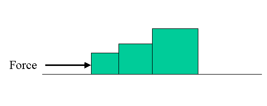

Blocks of mass 5, 10, and 25 kg are lined up from left to right in that order on a frictionless surface so each block is touching the next one. A rightward-pointing force of magnitude 14 N is applied to the left-most block.
[a] What is the magnitude of the force that the middle block exerts on the rightmost one?
What is the magnitude of the force that the leftmost block exerts on the middle one?
[c] Suppose now that the left-right order of the blocks is reversed. Now find the magnitude of the force that the leftmost block exerts on the middle one?
this is what i tried doing but i think I am totally off
Fm3m2 = m2a + 14 - m1a

They all have the same acceleration, so use F = ma on all-three-together to find a.
Then use F =ma (with that a) on individual blocks. :wink:

Apart from the right-most block (which you solved for in part a), each block has two forces on it.

No, a is the same for all three blocks.
The left block has two forces on it: 14 from the left, and the reaction force from the right.
The vector sum of those two forces is 5a.

The left block has two forces, 14 and R (the reaction force from the middle block), so F = ma means 14 - R = ma.
