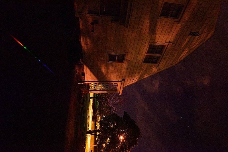

I taped a diffraction grating onto the lens flange (lens side, not camera side) to image some spectra- I was hoping to compare Jupiter, Spica, and Arcturus. For whatever reason, my old Sony worked much better for this- I think that Sony puts their sensor much closer to the lens flange than Nikon so the spectra still fall onto the chip. I ended up having to use a wide-angle lens to capture the spectrum, the trade-off being much less throughput. Images from my backyard- one of a streetlight (with Jupiter and Spica visible), and the other a neighbor's back porch light. These are 6s ISO 1000 exposures:

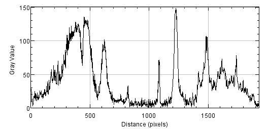

Unfortunately, the planet/starlight was just too faint for me to capture. The lights, however, have measurably different spectra (first one is the streetlight, most likely a Sodium lamp), the second an LED. Note also, the horizontal axis goes from red to blue and you can clearly see the Sodium lamp spectral peaks:
(for comparison: https://image.slidesharecdn.com/201...-all-you-need-to-know-7-638.jpg?cb=1358421058)

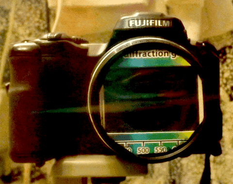

I carved my diffraction grating to fit my lens.

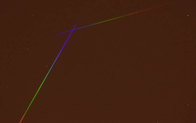

Success!
As per the image in post #4, I put a grating sheet in front of the lens and was easily able to get spectra of Jupiter, Spica, and Arcturus. The spectra are about 10 degrees off normal, so it took me a bit to realize that I can't look at the object itself in order to capture the spectra. By happenstance, the spectra of Jupiter and Spica appear together- Jupiter is off the frame to the upper right, Spica is off to the left to the lower left:

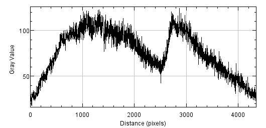

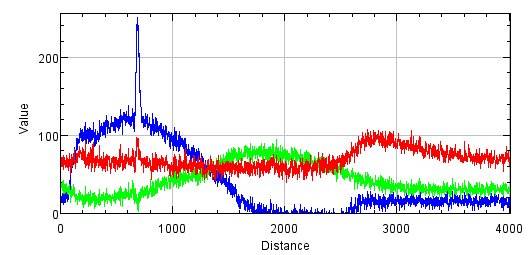

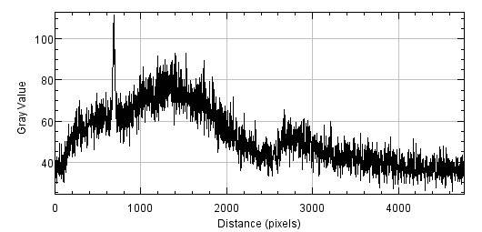

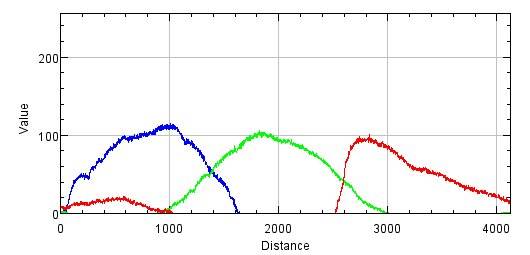

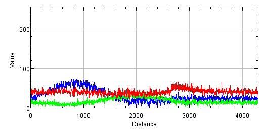

Now, using this to make quantitative measurements is tricky: Bayer filter, etc. Here are RGB lineplots through the spectra of Jupiter, Spica, and Arcturus:

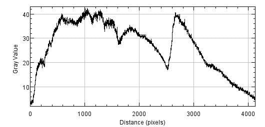

You can see where Jupiter's spectrum overlapped Spica's (the narrow peak). It's not immediately obvious how these correspond to the different colors, but if I plot the spectral intensity ('brightness') rather than the actual colors in the same order, the difference is more clear:
Now, Spica's curve shows how predominantly blue it is, while Arcturus emphasizes the red end. Not sure why there is a 'notch' in the yellow band...
