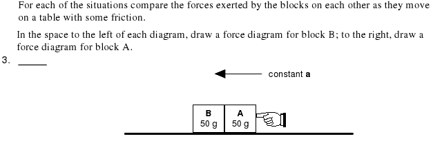

[Solved] Force Accelerating Two Identical Touching Blocks
The two blocks are accelerating at a constant rate due to the force of the hand, and air resistance is ignored.
I'll go beyond the question above and try to find why FB and FA are less than Fhand mathematically, since that would greatly help my conceptual understanding.

Force(A)net = Fhand + Ffriction + FB
Force(B)net = FA + Ffriction
Ffriction= μFN
F = ma

  • F = ma = Forcenet
  • Force(A)net = Fhand + Ffriction + FB
  • Force(A)net = Fhand + Ffriction + FB= ma (Substituting net force of Block A for f)
  • Force(A)net = 200 + (-0.1) + FB= 0.15 (Substituting in the values)
  • 199.9 + FB= 0.15
  • FB= -199.75 => FA=199.75

Finding Ffriction when treating both boxes as one large mass (100 g) using Ffriction= μF:
  • Ffriction= μFN
  • Ffriction= 0.2 x 1 (Substituting in the values)
  • Ffriction= 0.2
Finding Ffriction when treating both boxes as one large mass (100 g) using Force = ma = Net Force:
  • Forcenet = Fhand + Ffriction= ma
  • 200 + Ffriction = 0.3 (Substituting in the values)
  • Ffriction = -199.7

Edit: When finding the actual acceleration from a single 100 g block and using that in the 50 g block equations, everything fit perfectly.
It just tells you that you or whoever wrote this problem over-constrained it. Method 1 and 3 are identical. Method 2 should give you the right force of friction given. The trouble is that the acceleration would be wrong in method 2, and the force of friction is wrong in methods 1 and 3. It's like me saying shoot this cannonball 40m forward, at an acceleration of 40m/s^2 for one second; something has to give.
Thanks for the reply. Yeah, I think it was a fault of mine. :)
There's going to be no way that plugging an arbitrary number in for 'a' will give consistent frictions or even FA depending on which is being solved for.
So, the only question I have left is whether it is possible to:
Determine the acceleration of the objects by way of finding the friction on the two blocks as one solid mass, and then plugging that into Forcenet = Fhand + Ffriction= ma and finding 'a.' The 'a' can then be used in either of the two separate block equations to solve for the force of A or B on the other block.
Does that seem alright?
Edit: Okay, it's all good now.
