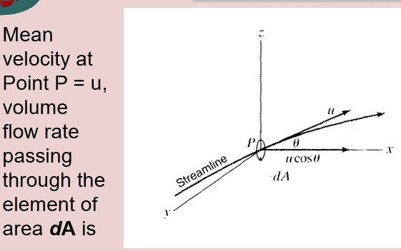

foo9008
676
dA lies on x and y aixs , right ? the author gave that the volume flow rate thru element A is ucos(theta)dA , why not
usin(theta)dA ? if u ' = ucos(theta) , it will become parallel to dA , right ? since u' will be parallel to x-axis...

dA is in the yz plane
