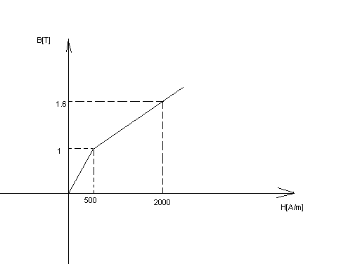

If we have a system that is shown in the picture, the upper piece is magnet, and if we know the following data:
S = 1cm2 which is area of material, S0 = 1.2cm2 which is the area of fissure. To bring these tow pieces of this system magnetic induction in the fissure should be B0= 1.6 T. Dimensions of this magnetic circuit are: l1 = 15cm, l2 = 10cm, l0 = 1mm. Determine the force needed to bring together these two parts, and magnetic energy "wasted" to establish magnetic field right before bringing these two parts together.
## w_m = \frac{1}{2}BH \\ F_m = - \frac{dW_m}{dx} ##
density of magnetic energy is ##w_m = \frac{1}{2}BH## volume of both pieces of material together v=(l1+l2)S density of magnetic energy in fissures ##w_{m_0} = \frac{1}{2}B_0H_0## ,
volume of fissures ##v_0 = 2xS## (x instead of l0 because it changes when there two parts are getting closer, and force has only x component, which is the vertical one in this case). when the lower part in moving volume of fissure, magnetic energy of fissure and magnetic energy of part with material change, only the volume of part with material remains the same. But, if we say that flux is constant then, the only thing that affects the change of energy is the volume of the fissure.
## dW_m = B_0H_0Sdx \\ F_m = - \frac{dW_m}{dx} \\ F_m = 2SB_0H_0 ##
Since i have B0 i can easily determine H0 which would mean that i solved this without using the magnetization characteristics diagram. Am i doing something wrong?
Picture of magnet
Magnetic characteristics of material diagram.

The magnetic energy density in the core
emag = ½BH = ( the area under the characteristic from H=0 to H=2000 ), because μ = dB/dH is varying in the interval.
Had μ been constant, the area would have been ½BH ( area of a triangle ).
Hope you can see it, I'm unable to explain it in english.

I don't quite understand this, does it means that i can use 1\2BH or not? What happens to the Wm(magnetic energy)? About that triangle you mentioned, i don't see any triangles when H is from 0 to 2000, i can see it when H goes from 0 to 500. But, how can i determine the value of H for which I'm finding density of energy. I mean if i use Amphere's law i have H(l1+l2) + Bl00 = NI but i don't have N and i don't have I either, what i am supposed to do?
See the attached.
As for the airgap, you calculate emag as the /////-area in the upper figure. emag = ½*B0*H0 [J/m3] (area of triangle)
As for the core, you calculate emag as the /////-area in the lower figure ( not a triangle ).

I think i understand that part now. After this i actually need to calculate the energy in the core using the diagram, i will try that it should work. Thanks.
