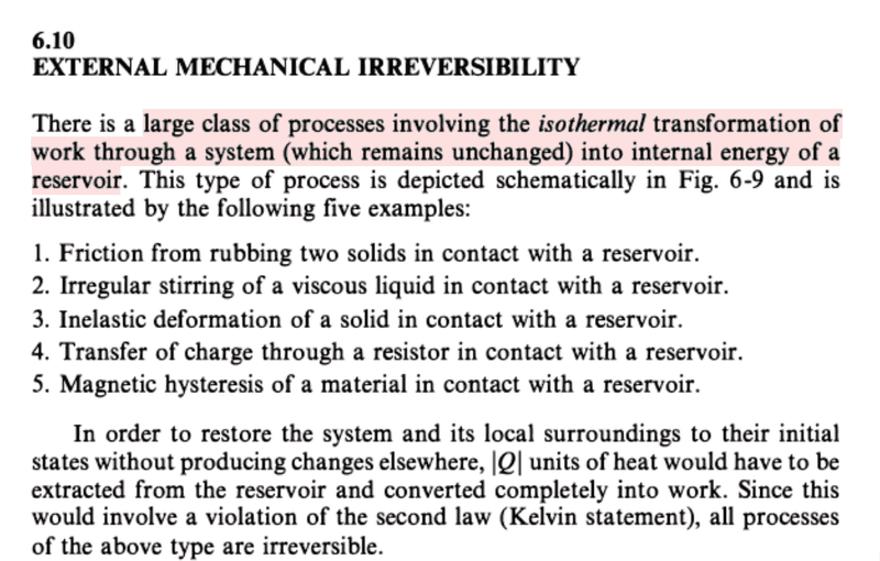

Finally, we reach the part that I have some major questions about.

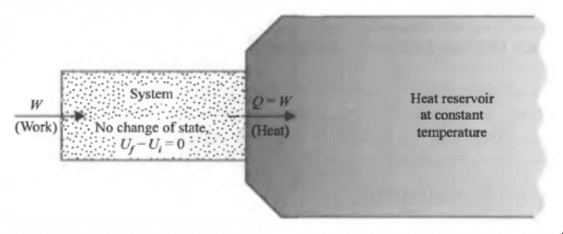

There is a large class of processes involving the isothermal transformation of work through a system (which remains unchanged) into internal energy of a reservoir. This type of process is depicted schematically in the following figure
Five examples of this type of process are
1) Friction from rubbing two solids in contact with a reservoir.
2) Irregular stirring of a viscous liquid in contact with the reservoir.
3) Inelastic deformation of a solid in contact with the reservoir.
4) Transfer of charge through a resistor in contact with the reservoir.
5) Magnetic hysteresis of a material in contact with the reservoir.
In order to restore the system and its local surroundings to their initial states without producing changes elsewhere, ##|Q|## units of heat would have to be extracted from the reservoir and converted completely into work. Since this would involve a violation of the second law (Kelvin statement), all processes of the above type are irreversible.
