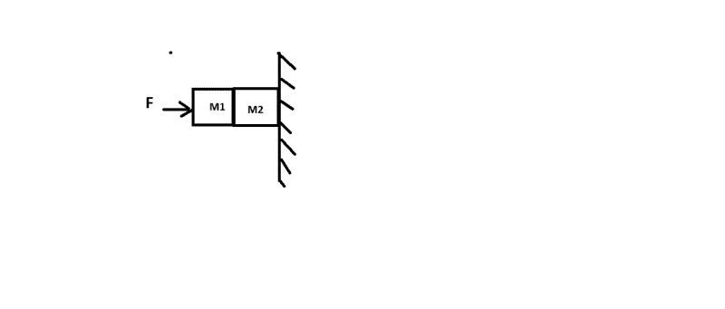

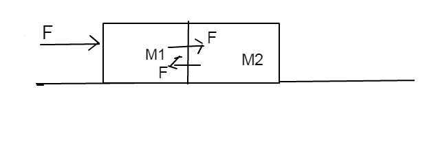

Force" F"is applied on M1 .Although force applied is not directly on M2,but it will also experience this force" F" via M1,right?
But I don't think it is correct.Because it implies that no matter how big the force on M1,the net force on M1 will always remain zero.And there will be unbalanced force "F" on block M2.It is like we are pushing M1 by force "F"but it is in it's place(not moving)instead M2 moves.Note that between M1 and M2 there will be frictional force ,as they are pressing against each other but it will be along the surface of contact and as there is no force to counter in y direction the frictional force will not come into picture.
As you seem to have realized, this is not the case. The force F is applied to M1. In turn, M1 will apply a different force on M2. That force will be less than F.
Than why in this case
There is friction between the two blocks as well as between the block and wall.
In this case, the blocks are not accelerating.

Not sure what you are looking for. Given the force F applied, you then deduce any other forces using Newton's laws.

but in the case when blocks are pushed against wall
the force will be equal to F.Why?That's what I am looking for.
gracy said:
ok.I can point out.
In the first case, the blocks are accelerating. Thus, there must be a net force on each block.
In the second case, when pushed against the wall, the blocks are not accelerating. Thus, there must be no net force on them. (Which implies that the force between the blocks must equal the applied force.)

Expanding what Doc Al just said:
in "the accelerating case" (and taking the horizontal axe oriented to the right) you have:
##F = (M_1 + M_2) a##
##F-R = M_1 a##
## R = M_2 a##
R is (the magnitude of) the force the second block exerts on the first block and also it is (the magnitude of) the force the first block exerts on the second block.In the "against the wall case" you have:
##F - N = (M_1 + M_2) a = 0##
## F - R = M_1 a = 0##
## R - N = M_2 a = 0##
N is the "Normal Force" the wall exerts on the second block.

I think in post #11 ,you have explained how horizontal forces add up to zero,so there is no horizontal motion .But as we see in real observations there is no motion in vertical direction also.So,here friction comes into picture.It balances forces due to gravity.
f 1(static friction force acting on block M1)=M1 multiplied by g
f 2(static friction force acting on block M2)=f1+ M2 multiplied by g
Right?
Right?
Looks good to me.
