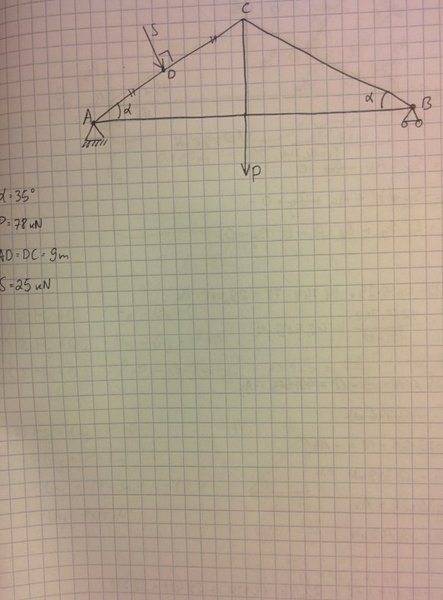

Handwritten sketch of a pin-supported truss with apex C, pinned support A and roller support B, load P pointing down at C, member force S acting on member AC at D, and angle alpha marked at A and B.
Given:
AD=DC = 9m
P=78kN
S=25Kn
Angle alpha = 35 deg
A is static but B is movable
I need to solve forces on the bases A and B
I do not understand where do I mark the forces if there is a base that can move.

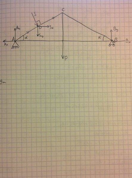

My attempt:
Hand-drawn free-body diagram of a two-support truss on graph paper: pin support A at left with reactions Ax and Ay, roller support B at right with reactions Bx and By, peak C at top, joint D on the left member with load S resolved into Sx and Sy, and a vertical load P at C.
I am not sure whether there should be Bx or Ax.[/B]
Is there only By on the base B? If so, is the B vector still calculateable with trigonometry, or the only force there will be By, without any Bx?
