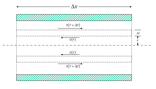

8-11 considers two radii r and r+Δr on the same side of the central axis. Because of the velocity (fastest in the cental axis) the relative velocities create opposite drags either side of the elemenrt
8-12 considers an entire disc of radius r, so the opposite sidea of it are on opposite sides of the central axis. The same velocity profile leads to drag in the same direction on opposite sides.
See Chet's diagram above. The two τ(r+Δr) are in the same direction, but in opposite direction to τ(r).

for 8-11, since the velocity profile is drawn from left to right ( same direction) for both r and r+Δr ,m why it will create opposite drags?

The velocity is greatest at the central axis. The annulus just inside radius r is moving faster than that between r and r+Δr, so drags it in the forward direction. The annulus just beyond r+Δr Is moving more slowly than that between r and r+Δr, so drags it in the backward direction.
