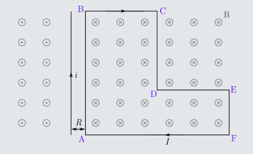

In a system as described in the picture, what would be the force that the infinite wire with a current of i exerts on the wire BC?
F=BILsinΘ
μThe magnetic field is supposed to be B=μ0i/(2πr). I think that the force would be aimed upwards.
