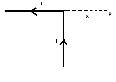

Diagram of a long straight wire bent at a right angle: a horizontal segment carrying current I leftward and a vertical segment carrying current I upward, with point P on the horizontal extension at distance x from the corner.
x represents the distance between the wire and P.
The wire has infinite length.
What is the magnetic field created by the wire at P?
B=μ0I/2πr
I thought the the first part of the wire creates a field equals to μ0I/2πx (directed inwards the paper/screen), and that the second part doesn't affect the magnetic field at P. However the answer is μ0I/4πx, where is my mistake? I know it's a simple problem but we have just started studying this, thanks in advance.
That's the field from an infinitely long current-carrying wire. (Meaning: No end in sight.) What you need is the field from a semi-infinite wire. (There are end effects.)
So basically because it's a semi infinite wire I need to divide the field it creates by two?
Exactly. (You can appeal to symmetry. An infinitely long wire can be thought of as two semi infinite wires joined together. So each piece contributes half.)

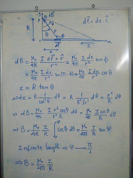

You can find it by mathematics too, hope it can help you :wink:
  • Handwritten derivation on a whiteboard of the magnetic field at point P from a finite current-carrying wire along the x-axis, using Biot-Savart law, ending with B = mu0 I / (4 pi R) for an infinite wire.
