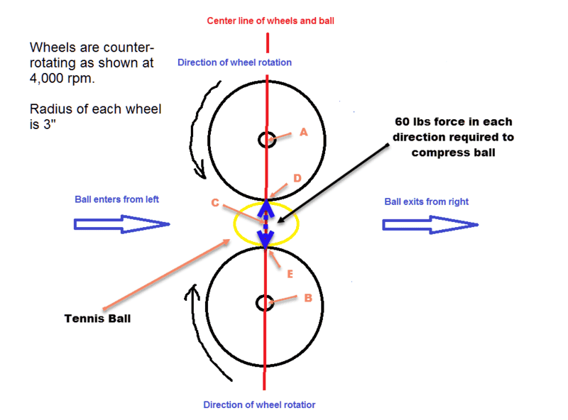

I am trying to figure out what torque is applied to 2 wheels counter-rotating at 4,000 rpm when a tennis ball is squeezed between them and then propelled forward (because the wheels are counter-rotating).This is how a tennis ball machine propels a ball forward. I know the distance between the edge of the counter-rotating wheels and I know how much force it takes to compress the tennis ball so it fits between the wheels, ie about 60 lbs, so I guess that's 30 lbs on each wheel. The traditional formula of Torque = Distance * Force * sin(theta) does not work because the force is being applied in line with the radius against the edge of each wheel towards the axle. Sin (0 deg) or sin (180 deg) in that equation are 0 so the equation yields 0 torque but that cannot be the case. It's kind of like applying breaks to the wheels of a car but not stopping. Radius of the wheel is 3".
Does anyone know? Maybe there is a way to translate perpendicular force against the wheel edge into tangential force when the wheel is rotating at a certain rpm?
Torque = Distance (ie radius) * Force * sin(angle)
Torque = 3 in * 30 lbs * sin(180) = 90 * 0 = 0
But it can't be zero and also doesn't the rpm figure in somehow?[/B]
So if it is 6 pounds force to compress it (likw you'd push against a surface) then the surface is also pushing back with 60 lbf. So it is not 30 pounds per wheel, it would be 60 each.
Ok I guess each side of the ball then is exerting 60 lbs of force on each wheel, but even using 60 the answer using my equation is still 0.

I did that. Let's just consider the worst case scenario where the greatest force is being applied to the wheels at that would be at the point at which the origin (center point) of the tennis ball is on the same line as one drawn between the origin of both wheels as shown in the diagram I drew below. 60 lbs force is being exerted on each wheel at this point as that's what it takes to compress the ball until it fits between the wheel before it shoots out the other side. The deformation of the tennis ball is equal on both sides. That is the torque applied to each wheel by the resisting forces of 60 lbs on each side of the ball?
ABE is not an angle, but a straight line. The force is perpendicular to each wheel surface.
This seems like a simple problem that arises all the time. There must be a simple formula for it.

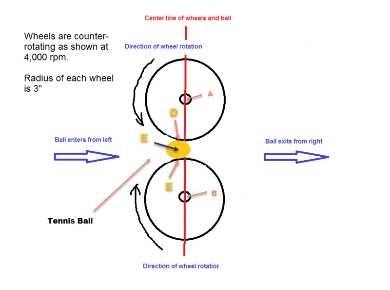

OK this is where is just enters
But I said "partly squeezed". You don't want any special point, such as just about to be squeezed or maximally squeezed; you want a generic situation somewhere between the two. Please label the diagram, not necessarily using the labels I defined, but assigning some label to each of the five points I mentioned. Might help to set angles ABE and BAD as θ.

ballboy said:
But I do have ABCDE labelled in the picture. Did you not see them?
Yes, that's fine, but do the same with the generic picture. And don't forget the frictional forces.

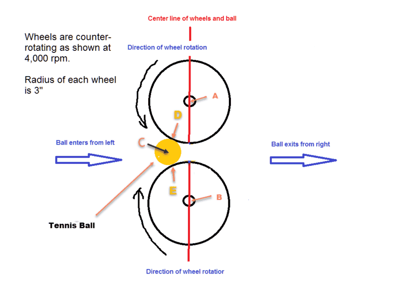

Ok here's the ball partly in. I don't know what you mean about frictional forces. What are they and how do I show them?
Consider the forces on the ball. Remember that if the wheels stop it should be in equilibrium in this position.
