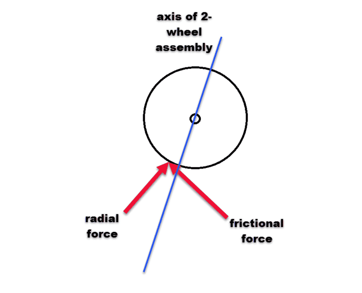

Sorry, I actually meant to say tangential not radial. It's clear to me that a force radial to the wheel has no torque about its centre.
So that leaves the torque created by the ball being gripped and compressed in between the wheels and propelled forward. I am puzzled about how one calculates what friction is created by that. Clearly the friction is less the less compressed the ball is. For example there would be less of a tangential force on the wheels if the rubber throwing wheels were further apart but could still grip the ball.
For a given geometry, we can determine the ratio between the normal force and the frictional force by considering that the forces on the ball are in equilibrium. Draw a free body diagram of just the ball and the radial (from the wheel's perspective) and frictional forces on it.
As I posted, the hard part is relating the distance between the contact points to the net force on the ball. It is complicated by the exact shape of the ball at this time, and the area of contact between ball and wheel. However, I think we can cheat by treating the ball as a simple spring. We know the distance between the contact points just before compression starts, that distance at maximum compression, and the force at maximum compression. That is enough to find the spring constant.

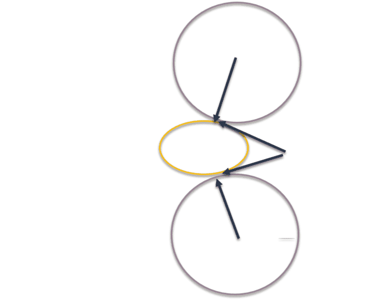

  • #33
How's this when the ball has already been squeezed between the wheels and is close to, but has not yet reached, the point of maximum compression. The wheel assembly is fixed but at a slight angle as you can see.

  • #34
Is that a picture of the ball? Looks more like a picture of a wheel.
For the ball, remember it will not be round. The direction radial to a wheel will not be radial to the ball, in fact "radial to the ball" does not mean anything at this point.
What can you say about the net force exerted on the ball by one wheel, in relation to the net force exerted on it by the other? What do you deduce about the directions of those net forces?
  • #35
Misunderstood you. How about this?
  • #36
ballboy said:
View attachment 210389 Misunderstood you. How about this?
Good, except that if those arrows represent forces on the ball it is clearly not in equilibrium.
If the normal force makes angle theta to the line joining the wheel centres, what is the relationship between the normal force and the tangential force?

ballboy said:
All I know is they are at angles to each other.
Let the net force on the ball from one wheel be F. What direction must it be in, in terms of your diagram in post #35?
If the tangential (frictional) force is FT, what is the relationship between that and F and theta?
  • #41
I was going to say F*cos(theta) but I think it's F*sin(theta)
  • #42
Yes, FT=F sin(θ).
As I wrote, the hard part is deciding how F depends on theta. It won't be feasible to do this accurately. It's really complicated.
As I wrote, a crude approach is to treat the ball as a simple spring. When it first makes contact with both wheels it is in the relaxed position. In terms of the value of theta at that point (θ0, say), the radius of the wheels (R=AD=BE), and the separation of the wheels' centres (s=AB), what is the distance DE?
