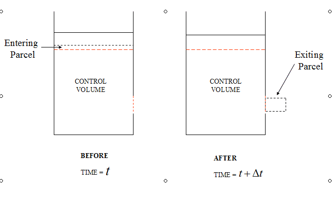

A container is full of water. A hole of cross section area a exists at the wall of the container, x height beneath the surface of water. (So speed would be v = √(2gx). Let's call it v for now). The density of water is ρ.Then why would the force imparted by the water gushing out of the hole on the container be F = av2ρ? I understand it has something to do with change in momentum, per unit time. But when I calculate it that way, I am not able to find change in momentum per unit time but just momentum per unit time.
So the way I do it is:
Volume of water water flowing out per second: av (assuming that velocity is per second)
Mass of water flowing out per second: avρ
Momentum of water flowing out per second: avρv = av2ρ
But we haven't computed the (change in momentum/time) but just (momentum/time). So would the answer still be valid?

To do this problem, you need to find the force that the tank is exerting on the fluid in the horizontal direction. This is equal and opposite to the force that the fluid is exerting on the tank. So, you need to do a momentum balance in the horizontal direction. I assume you are currently learning about momentum balances using the control volume approach. Can you think of a control volume that you can use to help solve this problem? Hint: It can be a pretty big control volume.

Hi andyrk.
Recently, in a private conversation, you indicated that you were able to relate to my post #12 in the thread Change in Flow of Momentum, and were comfortable with the approach and the answer. The method I am proposing to attack the present problem is almost a carbon copy of what was done in post #12. Are you willing to work with me to solve the present problem in this way, or are you not so sure any more? If you are willing to forego the simplistic explanation that you were taught and to do this thing the right way, I am ready to proceed.
Chet

The result is not incorrect, but it overlooks details that are important to you.
I have indicated a control volume in the figure (between the red dashed lines) into which fluid is flowing in, and out of which fluid is flowing out. The rate of flow in is equal to the rate of flow out.
I have also shown a Before picture in which a small parcel of fluid is about to flow into the control volume at time t. I have also shown an After picture at time t + Δt in which the entering parcel has just fully flowed into the control volume, and another small parcel of equal size has just flowed out.
If the density of the fluid is ρ, the cross sectional area of the exit hole is A, and the fluid velocity at the exit hole is v, how much mass exits the control volume within the exiting parcel during the time interval Δt? From continuity, how much mass enters the control volume within the entering parcel during the time interval Δt?
After you answer these questions, we will continue.

Hi Chet ,
I would like to continue the discussion so as to plug the gap in my basic understanding of fluids . I am interested in understanding how the force exerted by liquid on the container turns out to be ##ρAv^2## .
##ρAvΔt##
Same as before i.e ##ρAvΔt##
The horizontal force exerted by the container on the fluid in the tank (control volume) is equal to the rate of change of horizontal momentum of the fluid within the control volume; this is equal to the rate of horizontal momentum exiting the control volume minus the rate of horizontal momentum entering the control volume.

There would be atmospheric pressure at the hole . Isn't the horizontal force on the control volume patmA + Force exerted by container ?
Yes, but recognize that, if we are looking for the net horizontal force on the tank when fluid is flowing, there is also going to be a deficit of ##p_{atm}A## acting on the tank compared to the usual force of the atmosphere acting on the tank when no hole is present. These effects cancel out. If we work in terms of gauge pressures, this will automatically be taken care of.
